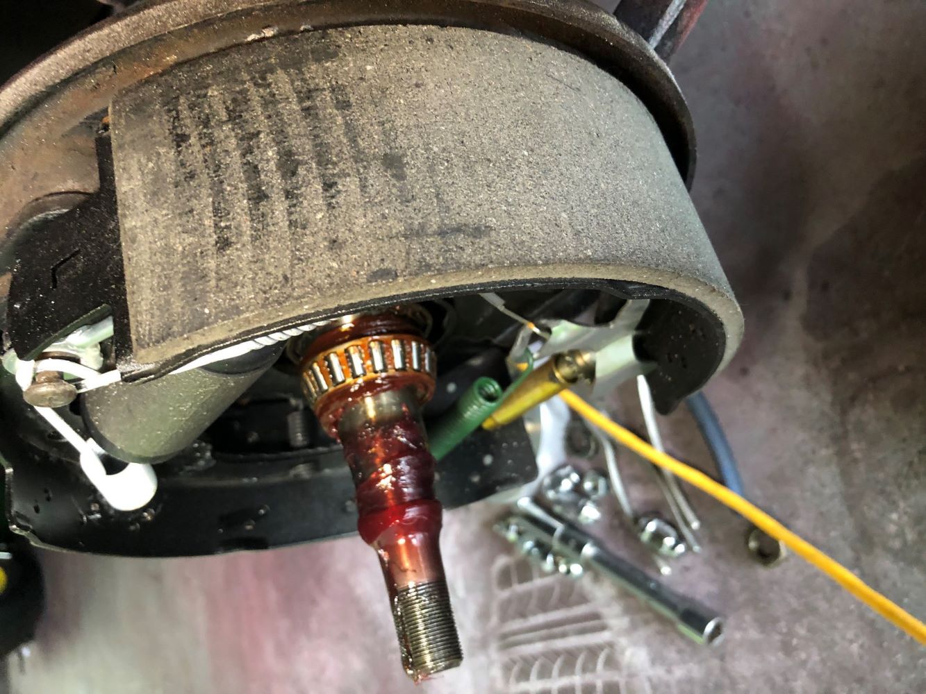

Well here are two pics of one of my front brakes.. does not look good, not sure what to make of them. I thought I had them properly installed and adjusted, but...
you can see the wear, its a wonder they worked at all! Also, the leading shoe seems to me to be a thinner lining.. both drum and shoes are new.....
pls help!!

Your first pic appears to show what I was talking about; most of the shoe area has not touched the drum.

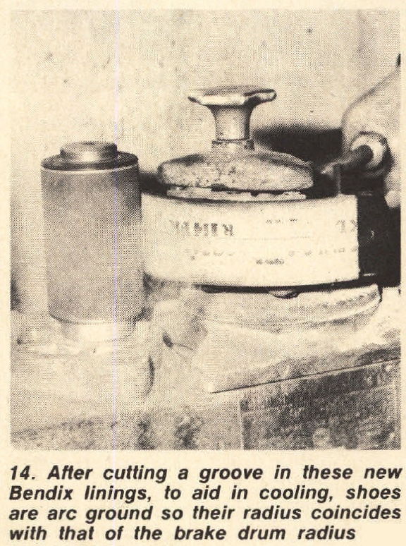

How can you bed-in the shoes? Well…keep stopping the car, without leaning too hard on the brakes until the shoes match the drums (if you wind up having to stand on the brakes hard enough to glaze the shoes, you'll have to wet-sand them as described above). Here's a pic from a good mid-'70s auto repair manual, of grinding the shoes to match the drum. Lookit that cancer-causing brake dust fly! Aw, that's awright, the machine operator was probably filtering his air through a cigarette. The past is a foreign country, making a '63 Valiant an unusual foreign car in 2023. One must adapt and make do as best one can.

I remember seeing those machines being used, one in particular comes to mind was housed in a glass box to contain the dust while operating. I don't recall if it is had an integrated ashtray. LOL
Most of the brake shoes from the 60's and older contained asbestos.
