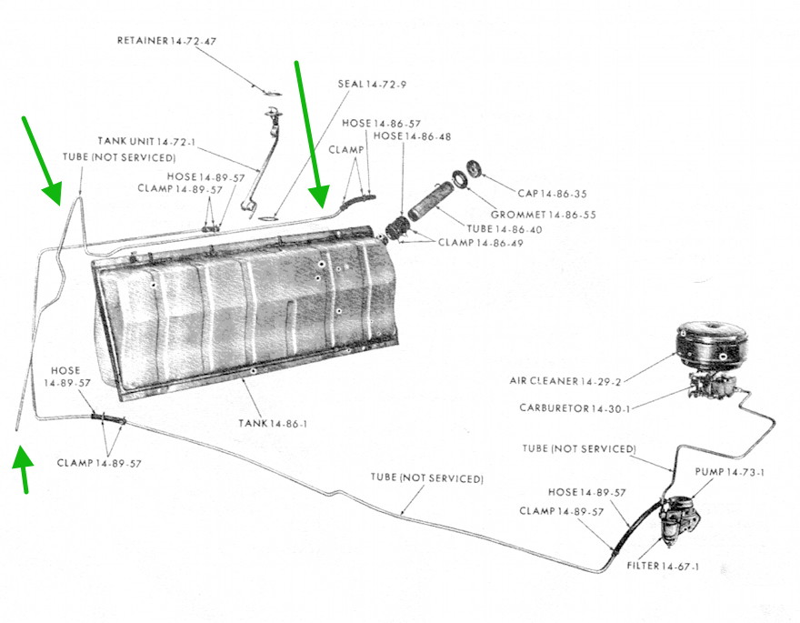

While you're typing, can you briefly explain the tank venting - is it merely a vented cap, or is there something else in the system that could fail? I have the original service manual, but it says nothing about the venting.
The cap is not vented. The tank is vented via a small-bore steel pipe which connects near the top of the fillpipe. It is routed along the tank and then upward to a high U-turn (to minimise the likelihood of liquid fuel sloshing out) and then down to under the vehicle. Here's the diagram, with the tank vent indicated by green arrows:
