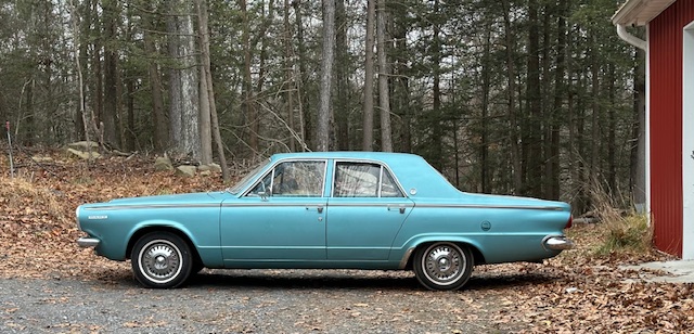

Does anyone out there with a properly set up stock \6 car have riding height measurements made "the old-fashioned way," like GM (:eek:) does 'em, from the flat bottom of the rocker, next to the pinch weld, a few inches behind the front / ahead of the rear wheel openings?
I reviewed the Service Manual's instructions, which are essentially a side-to-side differential measurement, but they won't answer my question, which is:
Is the rear of my car just a little tiny bit (like 1/2") low?
I ask because I don't enjoy driving with the butt low - it makes it harder to see forward and makes the steering too light and prone to understeer, and I'm just not sure whether my rear springs have sagged significantly in... 60 years.
Here are my measurements, on the very smooth, level concrete surface of my shop, unloaded, with a very empty gas tank, riding on B78/13 bias-ply tires inflated to the specified pressure (24psi, if I recall):
LF: 8-1/8" RF: 8-1/8"
LR: 9" RR: 8-1/2"
And here is a photo of my car from the side. The surface it's on begins to slant uphill slightly at the front.

60 year old rear springs will be sagging and fatigued, just how much is hard to say, the rear spring bushings are probably perished as well.
The FSM states the before a front end alignment is made, the fuel tank should be full, with the spare tire in the trunk.
The thing to do would be to replace all the front end suspension bushings before spending a dime on a lineup. Replace or re-arch the rear springs to get all the slop & sag removed from the rear end. You can replace all the bushings in the driveway, the exception might be the lower control arm bushings, which may require a press depending on what type of new bushing one uses.
If your steering box is worn it should be rebuilt or replaced with a new unit such as Borgeson sells.
You might want to up grade the one pot master cylinder to the 1967 and newer two pot type. Check out the Brake sticky section here for more info on the conversion.

Agreed, but I was curious whether, based on his experience, one of the members here believed that this particular car was sitting a bit lower than stock in the back.
Can't tell from the photo. Looking under the car at the spring's arch is it humped up, straight, or down? Humped up or straight indicates a sagging spring. Measure the distance to level floor from each end of the pinch weld under the rocker panels. Those four measurements should be close once you follow the ride height adjustment measurements listed in the FSM.
As I said in my first post, just above the photo:
LR: 9" RR: 8-1/2"
Height to the rear rockers is just the tiniest bit higher in the rear than in the front.

When I set front ride height, I measure from a level surface to the front attachment bolt on the K member. My ride height will be different then yours, since I am not running 13" tires.
If your car has had normal usage, you may want to add a "2" in front of the odometer reading. Normal usage would be about 10,000 miles per year, for the first 10 years, with the yearly usage tapering off after that point.

CONCLUSION:
I answered my own question.
In the 1964 Valiant AMA Specifications, page 24, are listed height from floor to bottoms of rockers and floot to bottoms of rear edges of doors.
It's not for the Dart, but the Dart can't be very much different.
Specifications (with 300# Front Seat, 450# Rear Seat, Full Gas Tank) are:
  • Front Rocker to Ground..........7.4"
    Rear Rocker to Ground...........7.0"
    Front Door to Ground...........11.7"
    Rear Door to Ground............11.6"
My car (empty) measures:
  • Front Rocker to Ground.............8.125"
    Rear Rocker to Ground..............9"L........8.5"R
    Front Door to Ground.............12.5"L....12.125"R
    Rear Door to Ground..............13"L.......12.375"R
So, if I get a chance to load up my car, I can tell for sure, but odds are it's a bit low, but not so severely low that I need to address it immediately.
