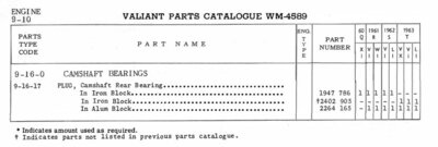

Looks like new plug ø for '63 on the iron blocks. That would make sense, because it corresponds to the new iron block casting numbers for '63—and that mysterious conrod oil hole about-face we were talking about.

Why not just buy new? Last line item here in brass, for example, or fourth up from the bottom here in stainless.
