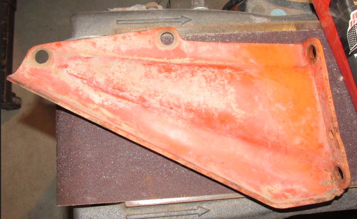

There are 2 braces, not sure what is the application difference.
One is much smaller than the other.
 Post subject: Re: Trans support brace
PostPosted: Sun May 28, 2023 12:10 pm
Posts: 9079
Top one is for automatic trans
Bottom one is for stick trans

Posts: 2721
Thanks Charrlie.
