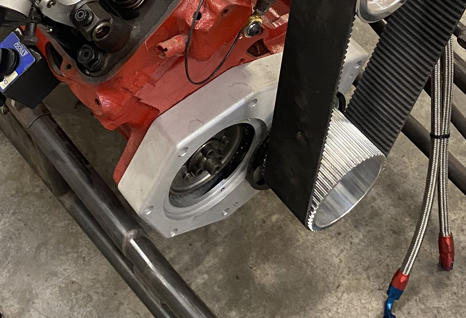

I got a bronze gear for the Magneto. I also have bronze for the oil pump, though I didn't end up using the stock location pump, rather a front cam drive Daley that runs the Fuel pump as well.
CJ
Part of Tyrde-Browne Racing
PostPosted: Sat Mar 16, 2024 11:46 am
Posts: 2637
CJ
Do you have a picture of your cam drive set up?
I would assume, all fabricated.
PostPosted: Sat Mar 16, 2024 12:19 pm
Site Admin
Posts: 7462
Location: Oregon
They aren't great, but these I had on my phone.
CJ
