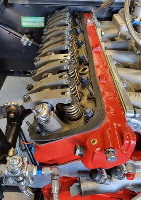

Speaking of heads, I picked up mine today from the machine shop.
50 cut, 4 angle valve job, slightly bigger valves, bronze wall guides.
Going to try and get it installed before our Eclipse friends arrive for the weekend.

I was worried about having a set of push-rods, but the Smith Bros set I got for the heavy milled head work.
I got most of it back together today.

Everything looks good today, nice run with water and it was all good.
