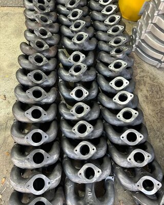

...I would be curious to the number of Dutra manifolds sold by Doug and AussieSpeed.
I have one of the rear Dutra's in my garage...
Nice that you have one of the "Pre-Aussie" Dutra manifolds... nostalgia.
AussieSpeed has done a great job picking-up that project and keeping it "alive & well".
Much better then Clifford... who let my Hyper-Pak reproduced intake manifold project "die".
Anyway...
I built the Dutra Dual casting equipment in 1989, as a college class project! (30+ years ago)
Made close to 1000 units before the casting equipment went "down-under".
I do not know how many Aussie has made but it still looks pretty popular. I just installed a set from AS on an engine I built for someone.
To me it a real shame the Hyper Pak exhaust project has died.
AussieSpeed just posted this picture on Facebook.
Who knows how many manifolds have been produced.
Doug made close to 1000.
