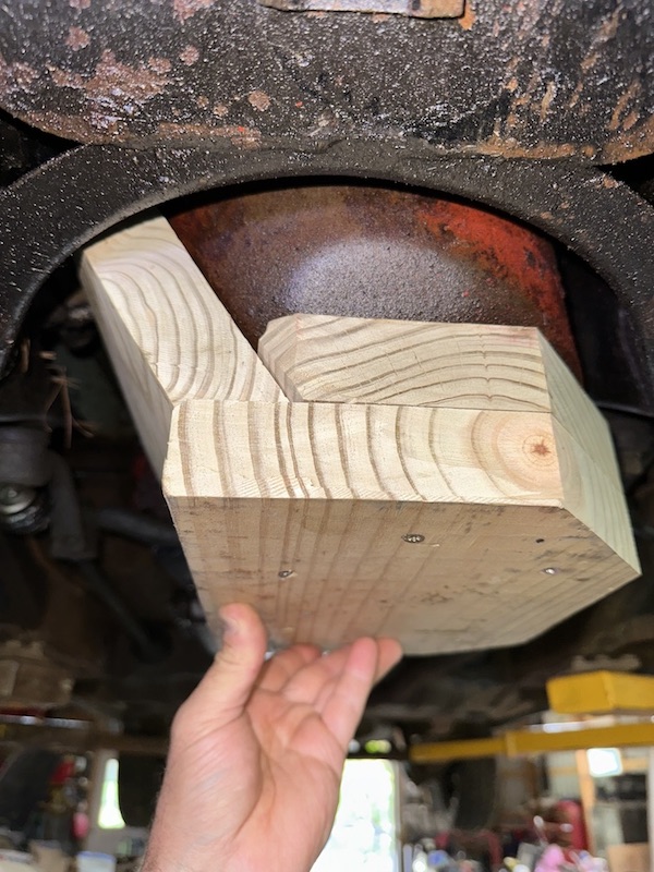

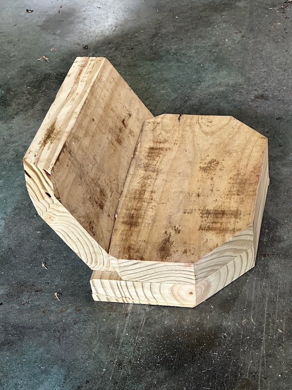

New Pioneer "Made by People who Work for People in the USA" mounts are on the way.
Now that I've got the technique down, and I've made my handy Slant-Six Jacking Cradle™, which helps orient the engine while I lift it, the job should take less than an hour.
Thanks.

PostPosted: Sun Jun 16, 2024 7:53 am
Posts: 14958
Very nice!
PostPosted: Sun Jun 16, 2024 8:50 am
Posts: 236
Location: Hudson Valley, NY
Thank you.
The idea was to make it less likely to tip to the passenger side.
If you look at the engine cutaway at the top of this page, it looks as though the center of gravity is roughly right above the passenger side oil pan flange, so that seemed to be the ideal jacking point, but, you know, it's a bit narrow, and would be unstable as hell.
So I made a piece the size of the oil pain, then another one that fit along the side and rested up against the flange screws, and made it protrude down just a hair longer than the bottom piece, so there would be some force on it, and put another piece under both to distribute the force.
I have no idea whether my figuring was correct, but the engine didn't show any tendency to tip toward the passenger side, and i was able to jack it up high enough to extract the passenger-side mount and bracket as a unit from the bottom (no need to mess with the fuel pump), so I'm happy.
- Eric

I think by "what durometer did you use", he meant to ask which grade of polyurethane your mounts were made of. It must have slipped my mind completely when I pointed you at them, to recommend that you specifically ask for soft rather than hard poly. Give Johnny a ping and see if he'll work with you. Failing that, put the too-hard ones up for sale here and on FABO; someone will, Shirley, square you up on 'em.
I like that lift fixture!
Thank you. I looked at the engine and thought, "I'd really like to lift it by the passenger-side oil pan flange, but that wouldn't work in the real world."
Then I watched a video where a guy lifted the engine with a patio paver between the jack and the oil pan, which made me want to take a shower, for two completely different reasons.
Then I held up a 2x12 cutoff, and saw that I'd need to trim off the corners to get it past the K-frame.
Then I got out the miter saw, and once I got to cuttin', I just couldn't stop.
– Eric
I used a plank between the floor jack and the bottom of the oil pan, with only one engine mount unbolted at a time. That is: first I swang the engine up such that it pivoted on the left mount while I replaced the right one, then the other way round.
