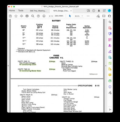

PostPosted: Thu Jun 27, 2024 12:14 pm
Huh. Wonder why they would put a 20A fuse on a circuit carrying 30 amps. Must've been the new math! :mrgreen:
PostPosted: Thu Jun 27, 2024 2:53 pm
Posts: 9094
"and personal experience for the blower circuit." Possibly aftermarket replacement parts used. Just changing the blower wheel could cause additional load. Just stating I would be more concerned about the draw on the blower circuit, than on the clutch circuit. I personally have never had to repair/replace components in the clutch circuit except for the clutch itself. I have had to replace blower motors, resistors, speed switches, and push button switches, along with overheated connectors/wires in the blower circuit.
