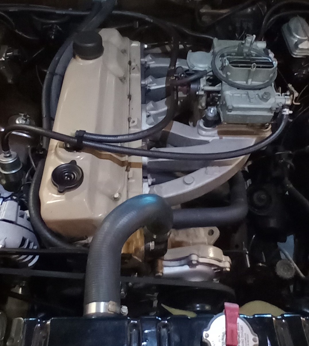

Found engine rebuild parts list. Yes, Mr. Rick ARP bolts were use in the rebuild. Not sure if the con-rods were resized. But by the comments here, they must have been. Called engine shop to get more info, closed for the long weekend. Business must be good. Thank y'all for the help with my stand pipe question. Doesn't seem to be the main cause for the rod knock. Tear down will reveal much. To be continued...

Up-date, pulled one plug wire at a time to try isolate knock. Only made knock worse. Now thinking loose oil pick-up, main cap bearing? Time to pull the engine. Removed the easy bits. Got to flex plate bolts. They were tight but not real tight. Not too sure torque spec for them, 60 ft/lbs? Anyways one had some 'discoloration/scratches' on it. (see pic) That 'could' be the knock. Not sure how to proceed. Reassemble, torquing flex plate in proper sequence and hope. Finish pulling engine and tear down.

A cracked flex plate makes a noise like a rod knock.
Loose bolts might also.
