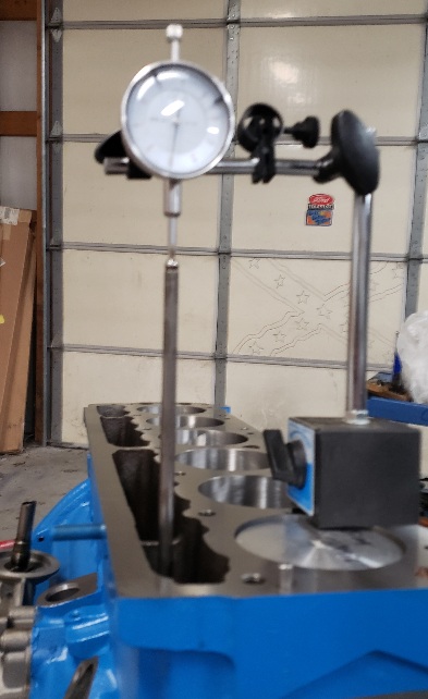

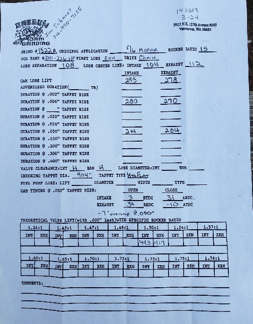

Degreeing the cam on this 83 slant six. It is a hydraulic cam and I'm not sure at how much lift I should read the BTDC measurement. I don't see a lobe center degree value. I'm getting 7 degrees BTDC at .02 measured on the lifter. If I measure at .05 x 1.5 for theoretical valve lift I get 2 degrees BTDC. Intake lobe center is 112 degrees. Attached is the OC cam card. Looks like the theoretical valve lift is close (1 degree measures 2 card says 3 degrees)
Is my last measurement correct? Should I advance this 2 degrees?

Measured at .05 and it is 5 degrees ATDC
So 8 degrees advanced?

Picture of setup.

Your intake centerline on the card says 104. I'd drop a solid lifter in it and use it for degreeing.
Check it at whatever lift you want before and after TDC. Use .020, .050, it doesn't matter. The center of those two readings give you actual centerline.

Intake lobe center line is 112 so retard 8 degrees.

Yes that should be correct.
