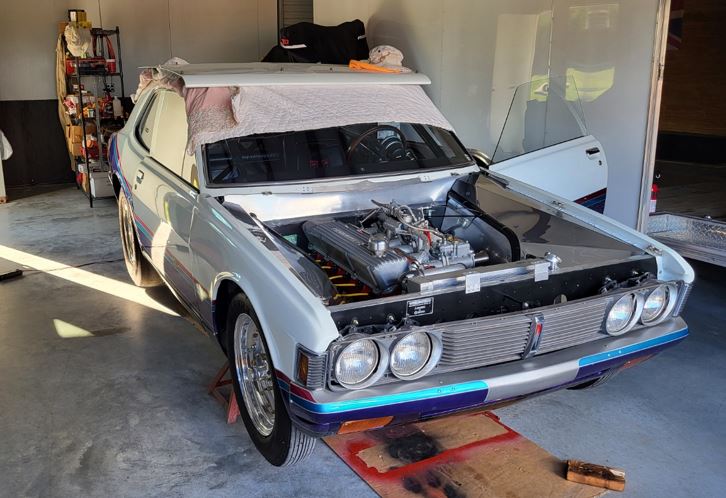

Posts: 2663
All my bruises have healed from all the internet shots I have been taking.
Back from a Southwest trip with friends.
I almost have finished all my shop interior walls and I will start moving all my junk out to the new shop.
Unloaded the Colt from the trailer where it has been sitting since August.
Going to a Test and Tune tomorrow.
Adjusted valves, and looked the suspension over good.
I had one Heim Joint jam nut loose on passenger side.
Drivers side rear Koni is leaking a little oil, that is bothersome as Will said they don't rebuild these anymore.
Measured tire diameters with the different air pressures to see what they were at.
Hoosier said they were 96 inches, I measured 93 and 93.5 inches.
Trying to see if I can get the right hook out on launch.
I don't remember back in August if it left straight.
It did not stick in my mind, so maybe it went straight and it was a non event.
I will try and watch for it tomorrow.
I will have a friend there tomorrow if Deb doesn't go.
Installed a firewall clutch stop to get the clutch tamer to work consistently.
