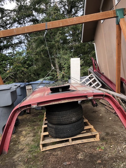

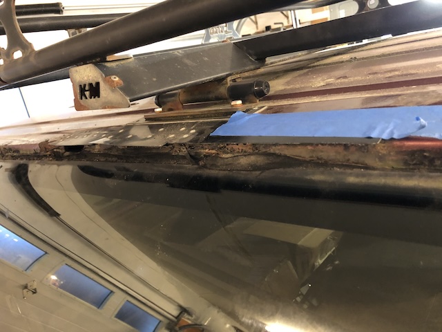

I know we all love pictures, so here is the rust I am looking at and the replace ment roof section I have. The two rusty areas pictured are the worst, but every window and door opening has at last rust bubbles in the drip rail above it, if not outright holes. And I won't even post pictures of the floor and quarters.
Realistically, I will probably end up cutting the roof off at the middle of the A pillars and the bottom of the B and C pillars. I think I will plan on using body panel adhesive to insert reinforcing rods into the A pillars before I weld them up, and I might glue some backing reinforcement plates behind the welds on the B and C pillars. I think the labor saved by replacing the roof in one piece makes that the best option.

PostPosted: Mon Oct 28, 2024 2:24 pm
Posts: 3303
Better off having the new roof welded.
PostPosted: Mon Oct 28, 2024 2:51 pm
Posts: 13431
Thanks, Don. I think that is the conclusion I have come to. Welding the new roof on with panel bonded reinforcement plates behind the welds.
PostPosted: Mon Oct 28, 2024 3:50 pm
Posts: 3303
Cap the pillars and see if you can make it a late model pop top?
PostPosted: Mon Oct 28, 2024 5:08 pm
Posts: 13431
Ooof, more trouble than it is worth, and I don't like the sun. Give me clouds and rain and air conditioning any day.
PostPosted: Mon Oct 28, 2024 10:58 pm
Posts: 13431
Well, I dropped the front headliner and looked around in the ceiling cavity with an inspection camera. Whoel top is coming off. Not worth it to try and piecemeal patch it.
