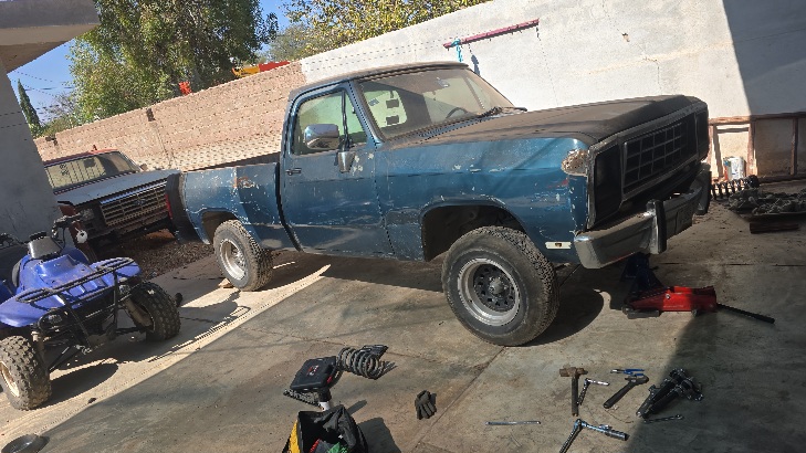

Will those work with a lift ? I added some 1 ton coils and it lifted it quite a bit 2 to 3 inches
PostPosted: Tue Nov 19, 2024 7:25 pm
Posts: 3303
Well they list the same PN for 1/2-3/4-1 ton so I'd think so. You picked "stock" 1 ton springs right?
PostPosted: Wed Nov 20, 2024 5:30 am
Posts: 209
I assume so. Didn't know they had different lift.
Here is a pic
