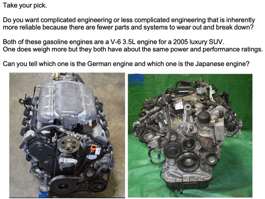

File comment: Choices

I am not responding to the thread in general, just to the meme... The engine on the left is a honda j35 v6 vtec engine without VCM. It was in odyssey 2002-2008?, ridgeline 2006-14, pilot 2003-2008, and maybe some of the acura side. Regardless of what the meme states that particular engine is every bit as reliable as a slant six. It is an engine that can absolutely do a consistent 300k miles with normal maintenance. T-belts every 100k or 8 years. Platinum plugs that never wear, at 200k they still have a normal 1.1mm gap. If you keep oil and coolant in the engine it will just run forever.
It is an engine that I would consider swapping into my valiant with a manual trans. Lightweight, compact, and decent power with NA 270 HP being easy and affordable.
I once saw one of those engines drive in WITHOUT A DRAIN PLUG off of the highway. His oil light came on so he drove it in. Not a drop of oil going highway speed with AC on in the 80+ summer heat. I personally installed a new drain plug, cleaned off the oil mess, and filled it up. That oil light went away and the engine ran fine. At this point you are all saying that the engine blew up 2 days later....nope. 10 years and 200k miles later he traded it in on a newer honda odyssey because it was burning oil and smoking at 285k miles.
I do enjoy the slant but some modern stuff is very good as well. I will say that the newer engines from brand H are far less durable than what they were in the 2005 era.
Against my better judgement, I'll respond to the memes, too:
• Everything mcnoople said, ×2.
• What exactly are we to pretend to have learnt about dependability, durability, or any other aspect of two engines by looking at pictures of them?
• Mechanics hate jobs that book out at numerous billable hours…?
• Modern starter motors last a long time. The starters themselves are better and more durable than they've ever been, and their job is easier than it's ever been; modern fuel-injected engines with modern oils start immediately every time, without any extended cranking. So the starter replacement job shown in this meme might happen once, but more likely zero times, in the life of a vehicle equipped with this engine.
• "Less complicated engineering that is inherently more reliable": Not necessarily, no. The complexity of a system is one of many factors that determine the reliability of the engine or car or whatever. Most "complicated engineering" has big benefits. My '14 Mazda has a 2.5-litre engine with 184 horsepower. It's zippy and zoomy and gives terrific fuel economy. It has 13:1 compression and runs well on regular 87 gasoline. I change the oil about once a year or 8,000 miles. It'll likely last well past my ownership of the car. Now take away all that "complicated engineering" and let's see if the magic still works. (it won't)
Yes, there are plenty of examples of needlessly-complex engineering that doesn't return much of any benefit to the user (VW-Audi, I'm looking in your direction, but GM, don't look so smug), but sweeping declarations that "complicated engineering" is putrid and yucky are just not on.

I created that meme and I have two of those Honda V-6 engines :D
One is packaged in my first generation 2004 Acura MDX SUV with 250k miles I bought after selling the 2006 Mercedes ML-350 SUV complete with hail damage and all its over bloated engineering, complication and high parts prices.
The other is packaged in my second generation 2009 Acura MDX SUV with 180k miles.
Both Acura MDXs are in great condition and, right after purchases; I did perform complete tune-up and maintenance on both including water pumps, timing belts, other belts, fuel injectors, plugs, coil packs, fluids and brakes all around.

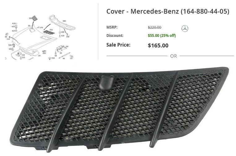

The Honda OEM parts cost about HALF of what Mercedes charges for similar parts such as the $220.00 plastic air vent grill on the hood that likes to break after a few years under the sun or a hail stone hits it. :roll:
File comment: $220.00 Mercedes Plastic Air Vent
