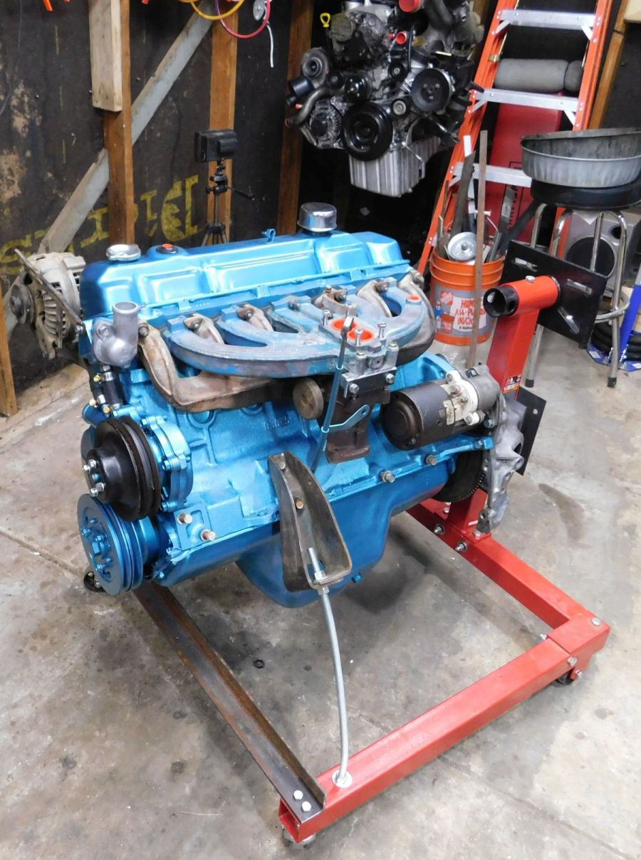

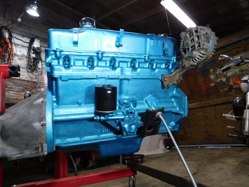

I recently refurbished a 1975 "barn find" engine that I acquired for $300.
I am in the process of fabricating a test stand based on a cheapo service stand and decided to share that project here.
I bolted a bell housing to the stand with 1/4" plate bracket to support the engine along with 1/2" all thread supports to stabilize engine.
I am in the process of fabricating a control panel with oil pressure, temperature and voltage gauges, tachometer, control switches and vernier throttle.
The goal is to obtain best performance with what I have and possibly install in my 1978 extended cab Dodge Pickup.
That's right; I intend to replace the 318 V8 with a 225 inline 6 and possibly convert from automatic to manual transmission. :D
Kindest regards; Scorch.

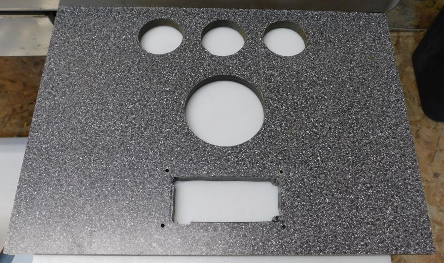

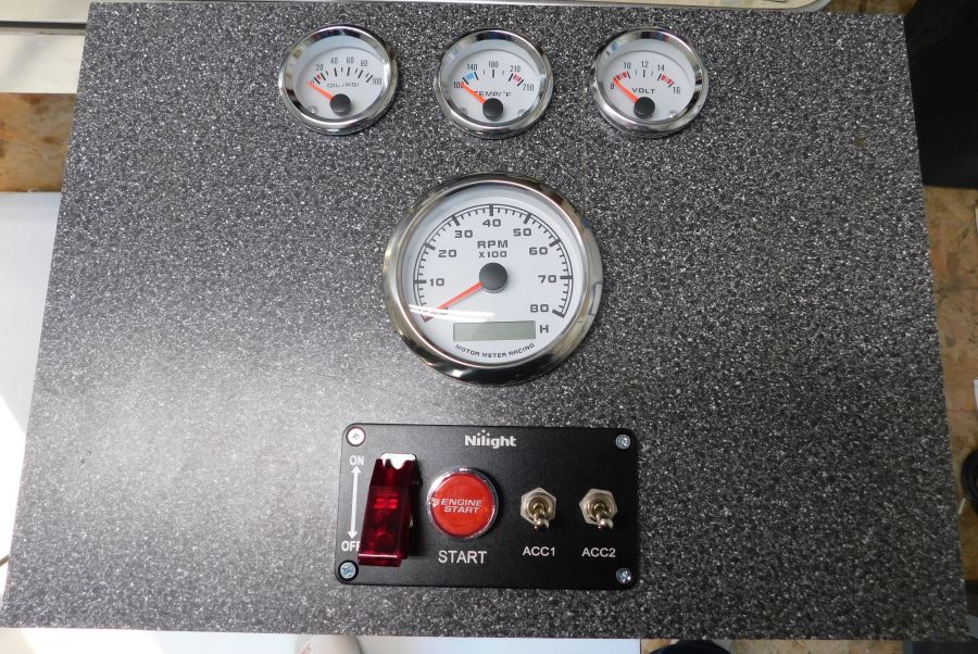

I had this new old stock phenolic board in the pile so I decided to cut some holes in it which are very useful to mount stuff in this very strong board. :)
I am still waiting for the vernier throttle cable to show up so; I'll mount that later. 8)
The control panel parts are just cheapo stuff from amazon.
Gauges: https://www.amazon.com/gp/product/B0CHVFL94Z
Tachometer: https://www.amazon.com/gp/product/B081JMDN2P
Switches: https://www.amazon.com/dp/B0BGBWNLFR
Vernier Cable: https://www.amazon.com/gp/product/B0D9BHVCZL

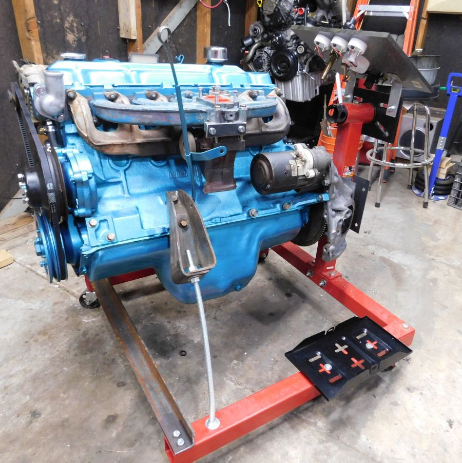

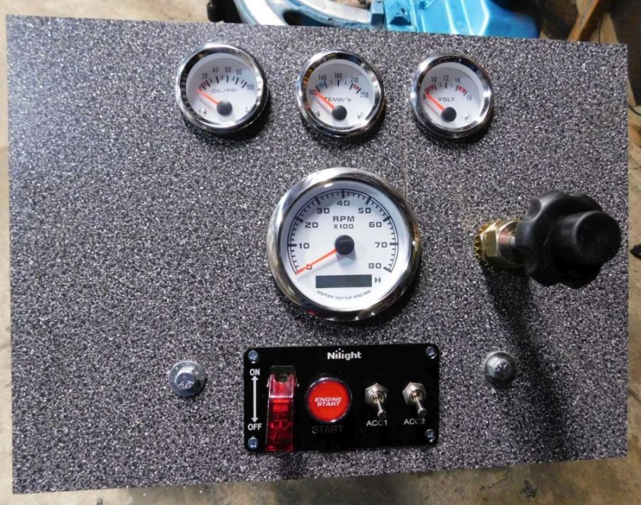

Managed to get a little more work done on the test stand this weekend.
Battery Tray and Control panel is now mounted. :D
Now that the vernier control is in place, the panel looks uneven because there is still a big, open space on the left side.
What should I install on the left side? A cup holder? :lol:
