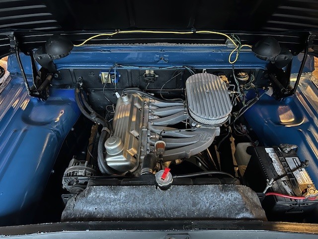

Should of listened to Dan. Truck Runs very poorly in cold temps. Very Spongey accelerating in first gear/bogs down and dies unless i rev the hell out of the engine prior to disengaging the clutch. I'm thinking it could be my timing with the electronic ignition/or something with the vaccuum advance.

That's a damnuisance. It is absolutely not my intent to laff or go "toldjya so" or anything like that.
I do not think it'll be fixed with timing or ignition adjustments, but by all means check all of that carefully. If the truck runs well once everything is good and hot, though, I think you kinda have your answer staring you in the face like an ogre. :(

What temperature are you driving in now? Am I seeing headers on the truck? Can't tell for sure. You may be able to build a heat box around some of the header tubes to get some more heat into the intake. Play with the choke adjustment and the accelerator pump shop may help some. I run a 4 barrel and headers year round in PA winters with no real problems. Just give the truck a couple minutes to warm up and it is fine. Not like a new fuel injected car or truck, but still very drive-able. My headers wrap up pretty close to the underside of my intake too.
Rick - in all fairness it’s pretty cold (15-25 degrees) when I drove it. We got heavy freezing rain with salt so I don’t plan on having it out for a while.
FYI - The electronic ignition I put in has an advanced street curve (Rick’s Mopars on EBay)
No headers - dual dutra dual exhaust manifolds to dual stainless exhaust. Holley 350 cfm carb has manual choke.
Oddly even after it warms up it performs poorly - which makes me think it’s a timing or vacuum advance issue? Does that make sense?
If the curve is too aggressive (advancing too much too early), it could lead to the poor low-end performance, hesitation/bogging, especially when I trying to accelerate from a stop.

15 degrees is pretty cold! :D If you leave the choke on a little does it drive differently?
I doubt the curve is the real problem. Is it pinging badly? What is the initial advance and what is the total advance.
If total mechanical advance is limited to not more that 30-32 you should be fine. To much advance generally slows down our race cars at the the high rpm end of the spectrum, not the low end.
I would definitely check for air leaks at the intake and carb. Does changing the Accelerator pump shot help the bog/hesitation?
