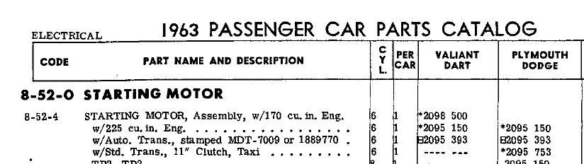

Breakout for this FPC extract:
2095 150: Chrysler gear-reduction starter, series-shunt wound
2098 500: Chrysler gear-reduction starter, series-wound
2095 393: Prestolite direct-drive (Bendix) MDT-7009 starter, same as 1889 770
2095 753: Chrysler direct-drive (solenoid) "tin can" starter
