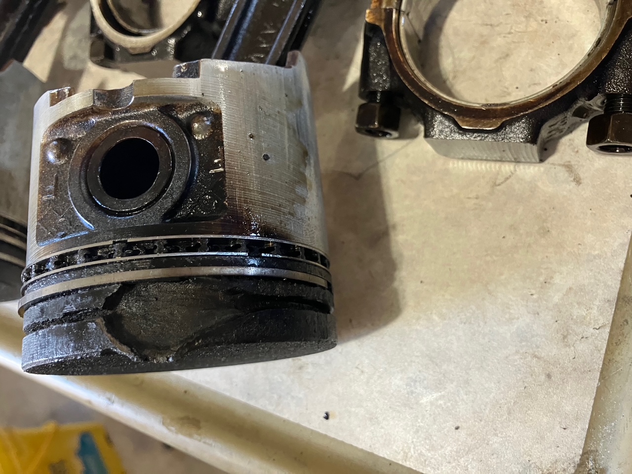

I finally pulled the engine apart that we removed from the truck after the Knoxville race. I think I found the problem. :D :D
Pretty sure that is why it had so much blow by. :D It also had a couple other top rings broken but still in place. This was a "quick" re-ring on an old engine I picked up for cheap. I cut the cylinder ridge and then did a quick hone and installed new rings and bearings.. I imagine the rings broke first then the piston went down hill from there. The engine had run 5 or 6 racing seasons in my Valiant, then was placed in the truck for the last 2 or 3 years. It made trips to London, Knoxville. Wilkesboro...etc, so it probably had 8-10000 road miles on it before this happened.
I already have a set of reconditioned rods with .030 over pistons on them. So I will probably just get the block cooked / cleaned and then bore it .030 over. Crank looks pretty good but will need a polish at least.

nice to find out what happened.
Looks like some of Charrile's Nitrous Passes pistons.
Maybe Ryan put the Hose sprayer on there when you were not looking?

At least it's not too horrible. :mrgreen:
 Post subject: Re: Covalt - 85 D100
PostPosted: Sun Feb 02, 2025 4:39 pm
Posts: 9390
So a 3/4" wide ring land should be Ok? :D Just run 20W 50 oil.

As opposed to rods kicked out the side......
PostPosted: Sun Feb 02, 2025 8:32 pm
Posts: 9390
Yeah! For sure. Really surprised it ran home 500 miles as well as it did. :D
