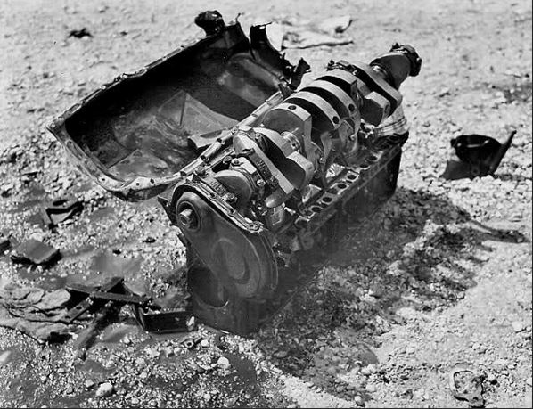

PostPosted: Sat Feb 15, 2025 4:57 pm
Posts: 2614
Seven main bearings on a 292. That makes a big difference in keeping the crank in one piece.
CJ
7 might help
But S happens
