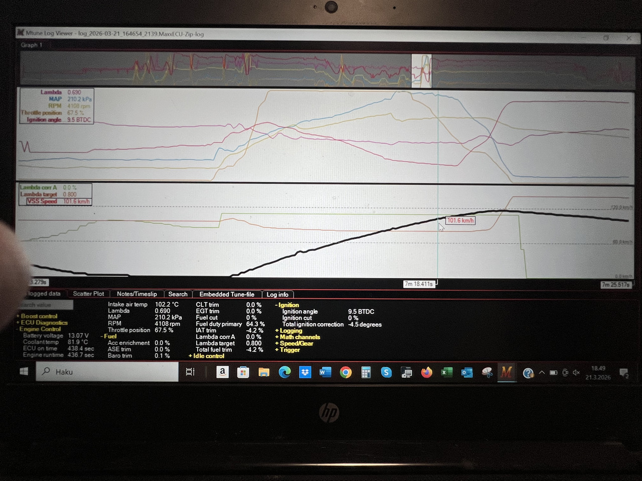

HX30 wastegate was 12.5mm and I drilled it to 16mm. After that I got max 1.1 bar boost (15-16PSI). 0-100km/h (0-62.5MPH) with ”D” gear uses 7.0 seconds. I like this better than T3/4 turbo which needed 1-2-D manual gearing to get the same seconds.

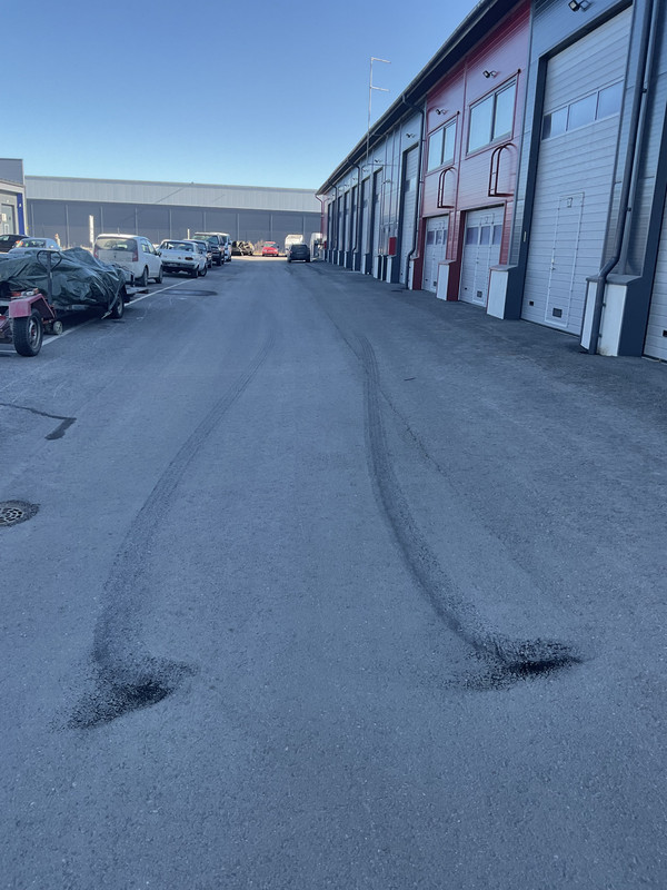

A thing I am doing later is a pushbutton set where I can choose the max speed available. This is because this is now dangerous - its really easy to get lost the drivers licence. It tested this close to my garage. There is not more than a bit over 100 meters from a traffic light to the garage port. And I did 0-100-0 in it! It is 40 km speed limit area and over 30 km speeding convert the driver a walker.
