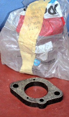

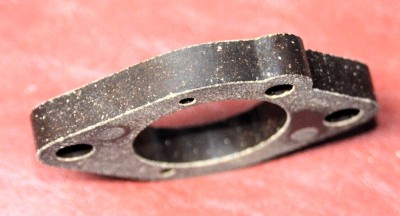

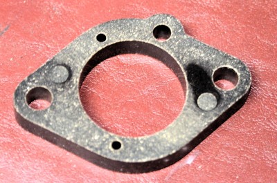

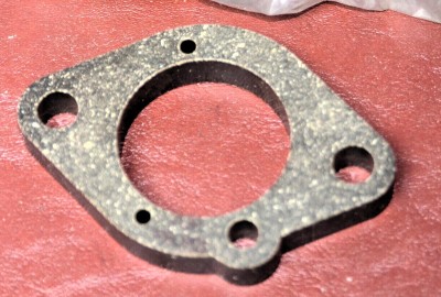

This is interesting. A thick factory phenolic (filled Bakelite) insulator with the same pattern as the '61-'73 1-barrel carb base gasket. Part № 2406 063. The first few 2406-xxx part numbers show up in '62, with more introduced in '63-4, but this 2406 063 number does not appear in any passenger car FPCs up through '69, well past when new 2406-xxx numbers stopped being introduced.
Also, strikes me a spacer like this would make problems with linkage and/or hood clearance in at least some of the '63-'66 passcar applications, so I'm guessing thiz a truck/van item. Lotta heat buildup in the engine bay of an A100 van, for example; wouldn't surprise me if this piece was used in those.
Still, would be an interesting part to have and/or duplicate, eh!

No, that's real clearly the mount pattern for a pre-'74 Slant-6 1bbl gasoline carburetor. Carter BBS, Holley 1920, Stromberg WA3.

That's an industrial/agricultural machine. The carb (an ancient type, maybe a Carter BB or an old-old Bendix-Stromberg unit) is rotated to make peaceful linkage compatibility with the belt-driven speed governor.

Got a PM over on FABO from someone who filled in the missing puzzle-pieces:
"This came from the 63 - 68 Dodge truck parts catalog.
Code 14-68-8.
Spacer, Governor to Carburetor with 225 engine after serial number 1268340
Used on some D-100-600 trucks"
All makes perfect sense.
