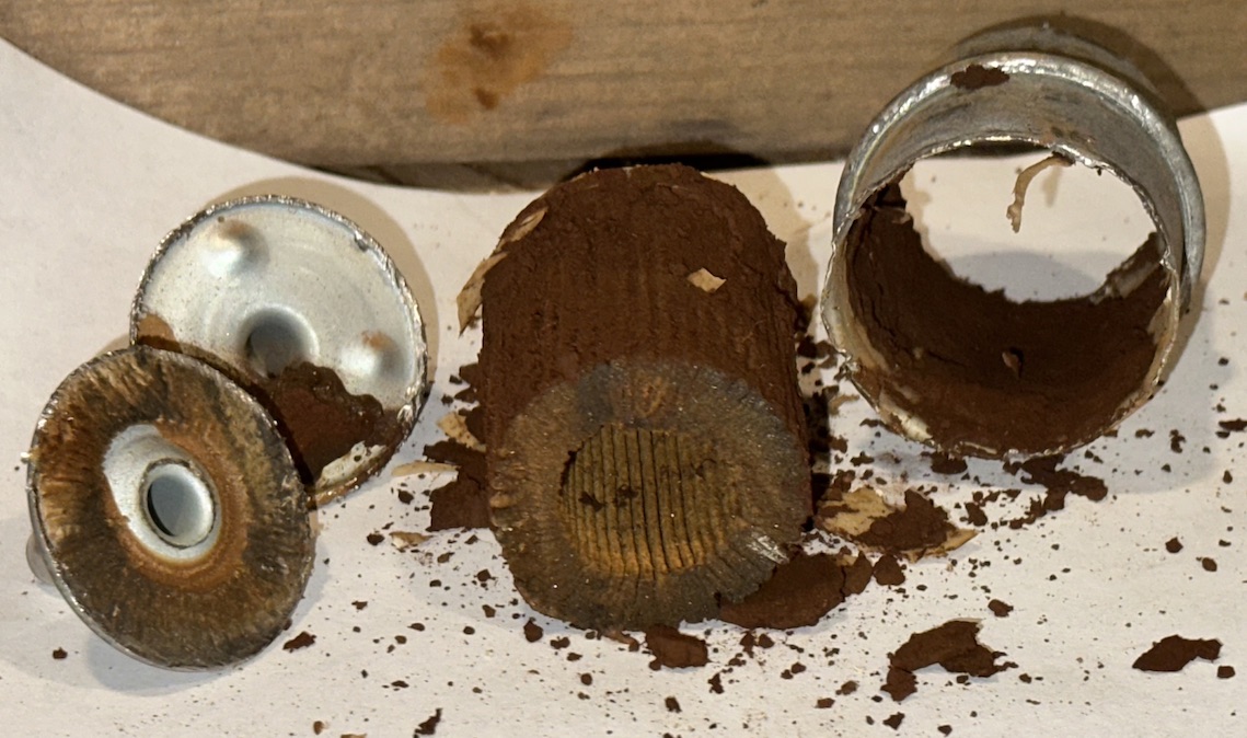

Because of how yucky the fuel inside FP#3 had looked, I had bought a clear plastic fuel filter, figuring I could put it in the hose between the pickup and the hard line, to see whether I could keep some of that dirty fuel out of the pump. Plastic fuel filters concern me on the pressure side, but should be okay on the suction side.
So, the new fuel pump is in, I'm messing with the distributor (its next door neighbor), thinking about installing the plastic filter, thinking about how to orient it in case it fills up with crud, and I look up and see the metal fuel filter attached to the carburetor.
And I stop.
And I grab a pair of Vise-Grips, release the spring clamps, pull the metal filter out of the hoses, and blow on the end.
Nothing.
I can't blow through it.

I replace the metal filter with the plastic one I have.
Reassembled, the car runs great.
The moral to this story: Steel fuel filters are great, look good, and are what you should use.
Unless you are resurrecting a car that's been sitting.
In that case, for the love of all that is Holy, use a plastic filter, and you can watch to make sure it isn't filling up with gunk, and save yourself from buying Fuel Pumps #2 through #5.

Glad you got it figured out!
The best idea I have seen when resurrecting an old car that has been sitting is to daisry chain about five clear plastic fuel filters together before the first startup. Then you can see if there is crud coming through the line. If there is, you just remove the filter closest to the tank when it gets clogged, then repeat until the filters don't clog anymore. Then install a single metal fuel filter and be done.
