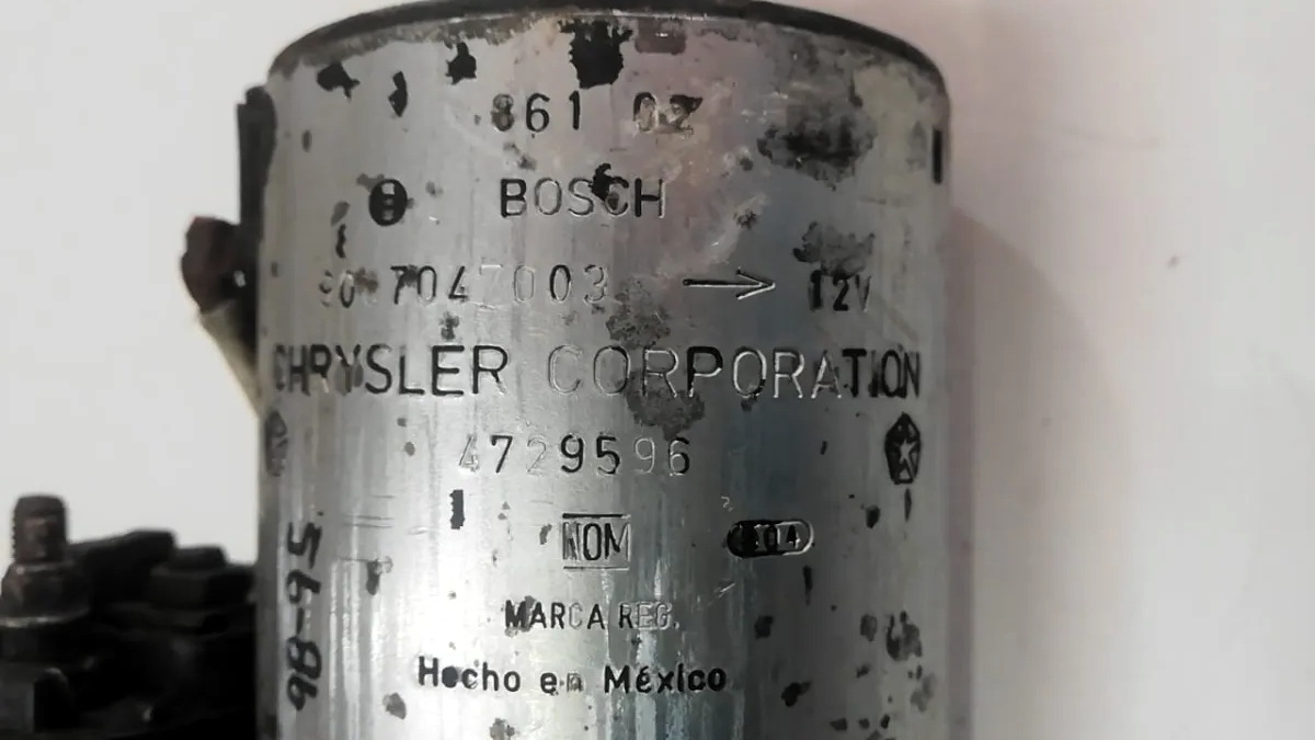

Just shortly ago, instead of working on a project with a looming deadline (it's looming even larger now) I picked at this mystery again. Don't recall what subchamber of a late-night rabbit hole I was in when I stumbled onto the actual story of this starter: it was used as original equipment in Mexico on at least '94ish to '98ish Dodge Ram trucks and vans with 3.9 V6s and 5.2 and 5.9 V8s. Locally made by Bosch in Mexico:

I didn't like giving up my alternate-timeline explanation, which was kind of giving me hope.
So I went digging further, and found some OE Bosch numbers, donned my virtual hip waders and went sloshing through AliExpress, and there I found – just imagine my shock and surprise – that new starters of this type are being made in China. On that subject, my rotating-electrics guy says "They've figured out proper metallurgy and surface treatment, so their starters and alternators are a whole lot better than they used to be; generally they're fine".
And now I had more numbers to plug into web searches, and with one of them I found a US parts vendor listing this starter, new, at a friendly price. I ordered one and had it sent to a friend in the states, asking that he put it on one of his Slant-6 cars and make me some videos. And here they are:
