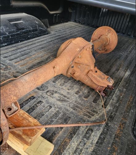

Posts: 2721
Got the last big part today.
3.23 Sure Grip in an 489 housing.
I have turned this $900 dollar field car into a $3000 field car.
