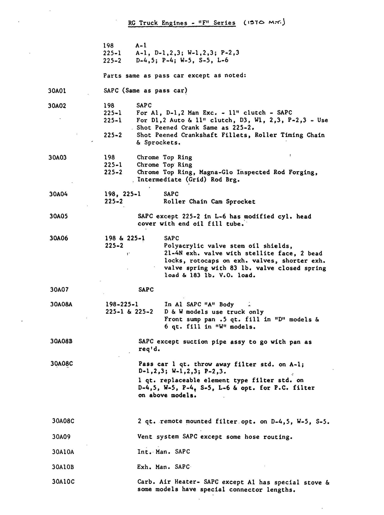

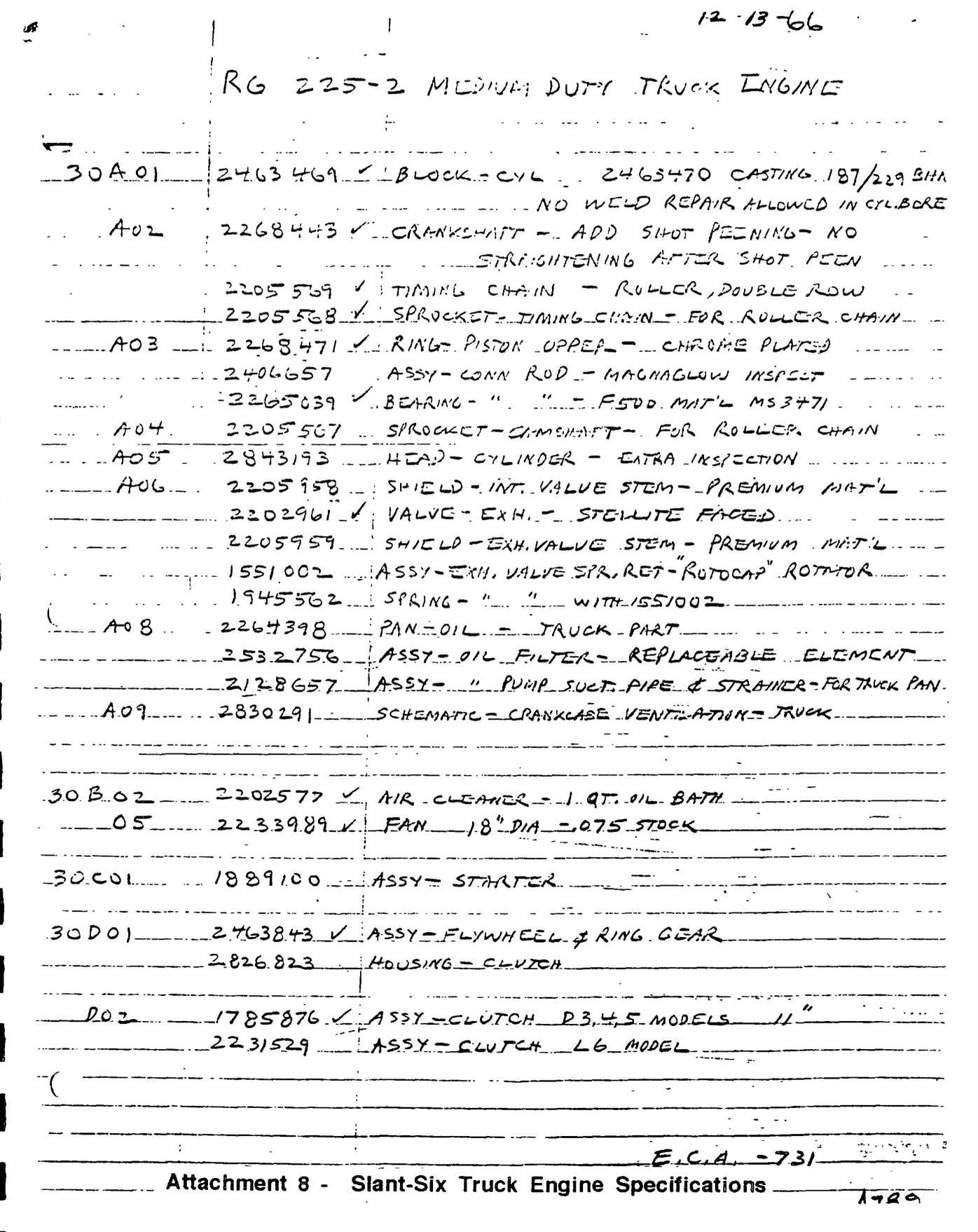

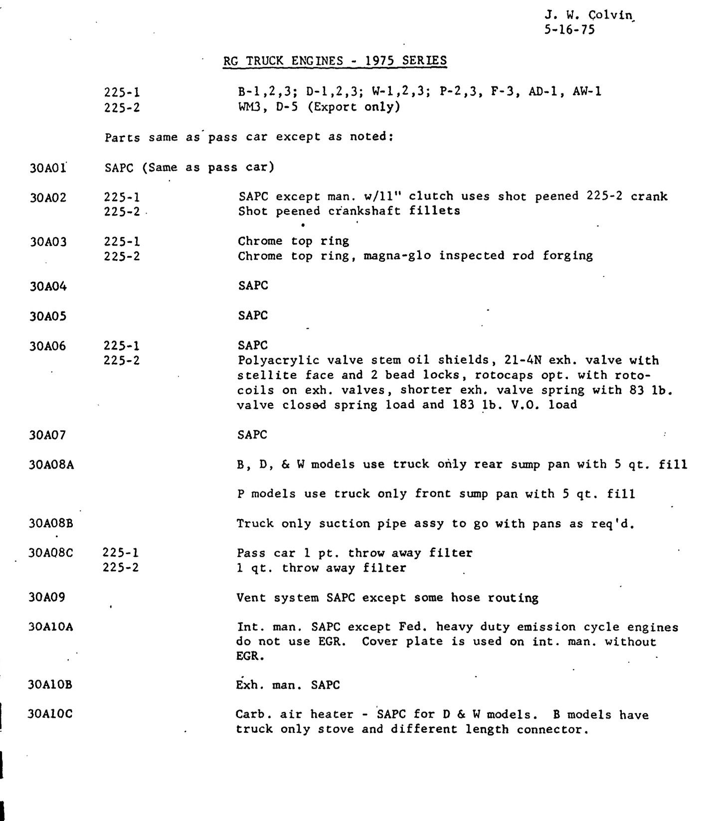

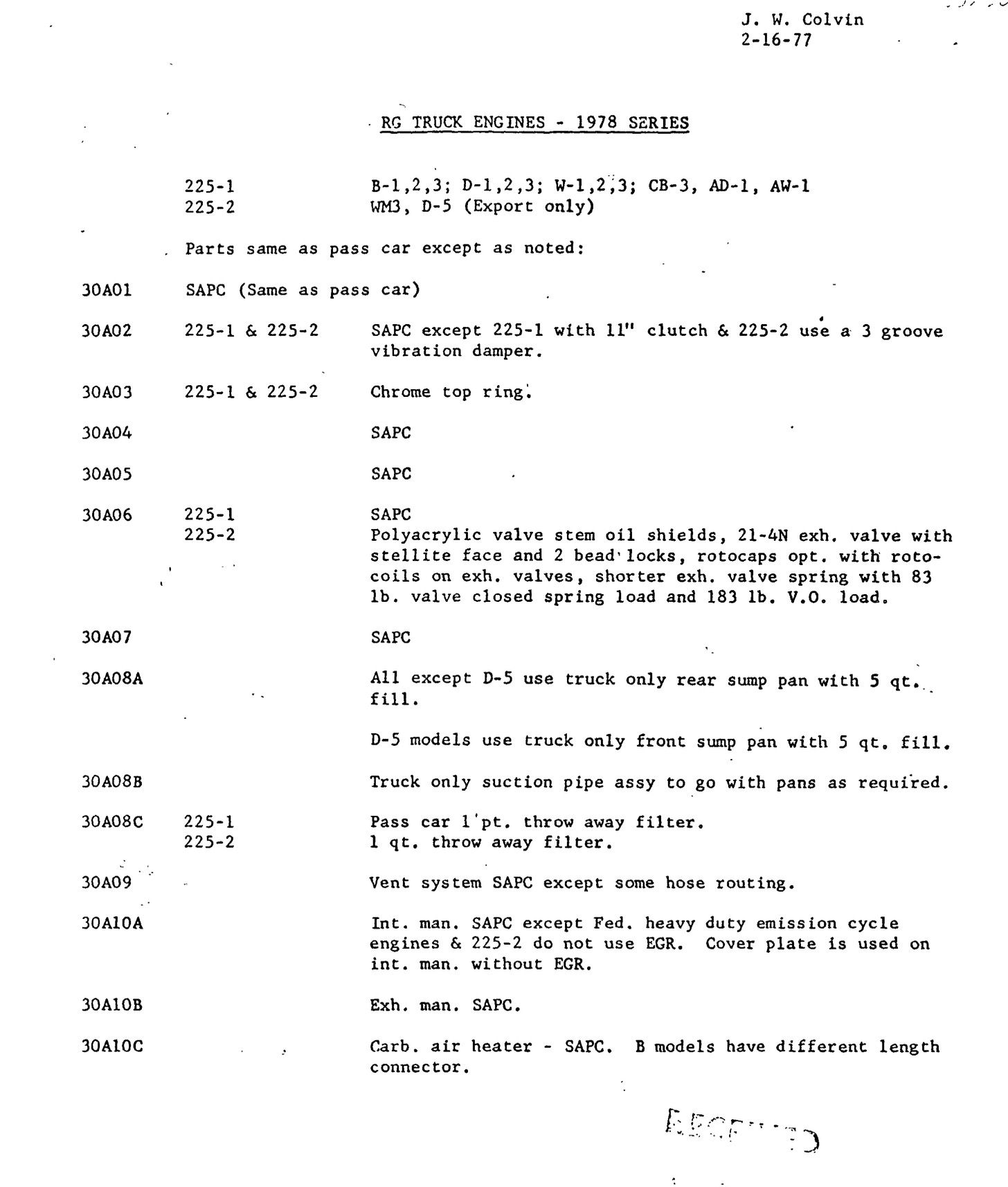

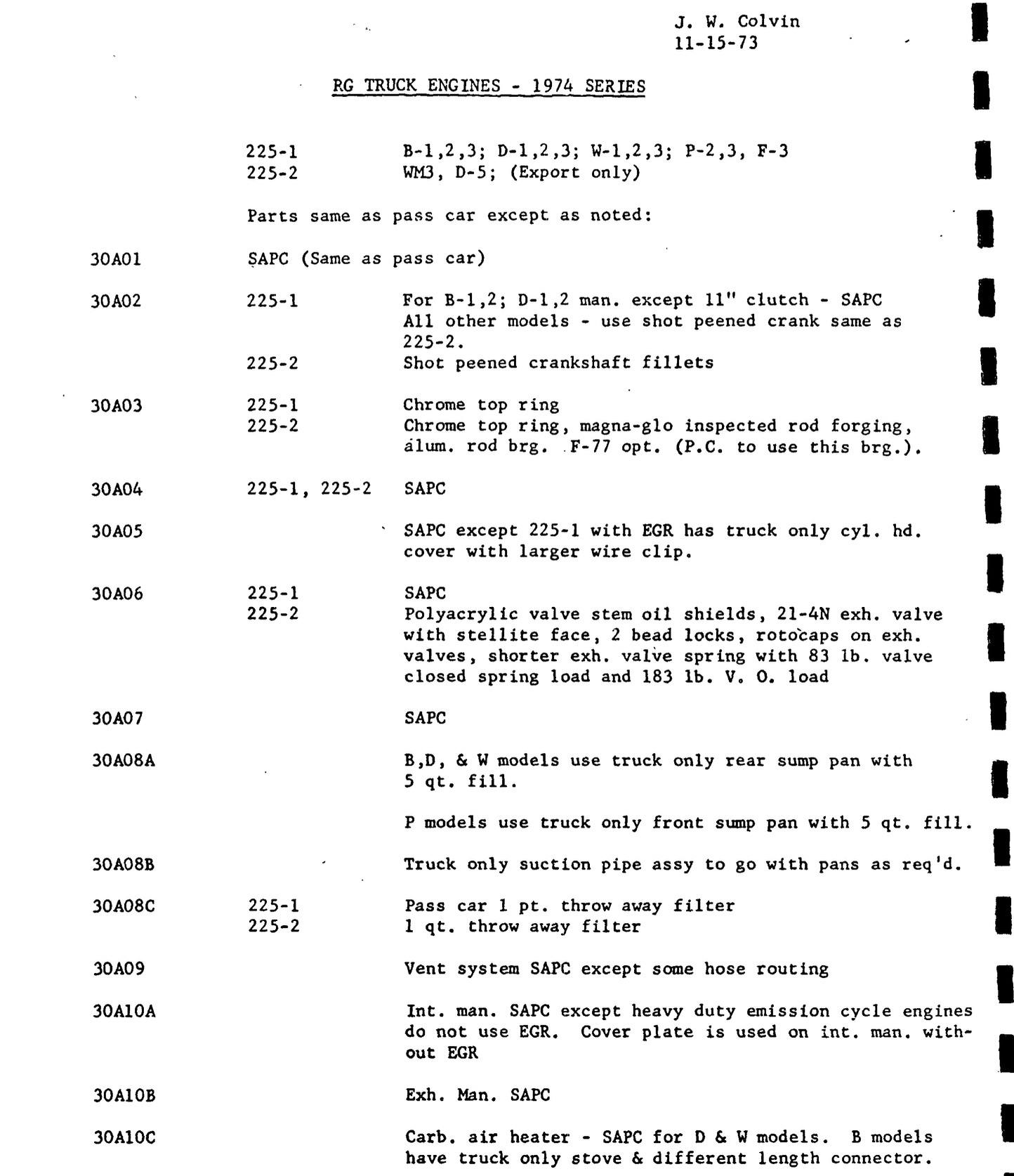

being a non automotive engine it would be interesting to know if it has a shot peened crank and exhaust valve seat inserts.
The 225-1 and 225-2 HD and XHD truck engines, put into much heavier-duty service than the industrial/agricultural applications, had shot-peened cranks and other upgrades. Valve seat inserts weren't on the list. Here're the '66, '70, '74, '75, and '78 225-1 and 225-2 upgrades:

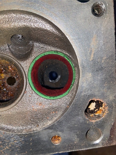

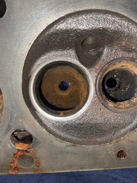

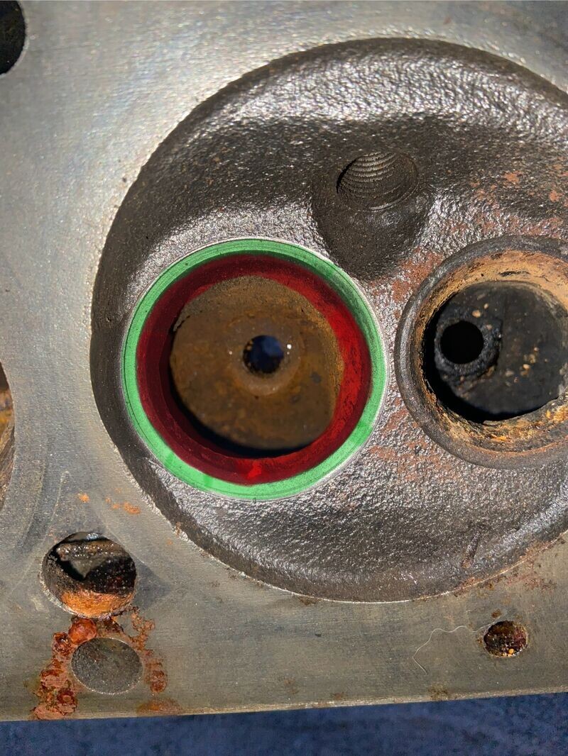

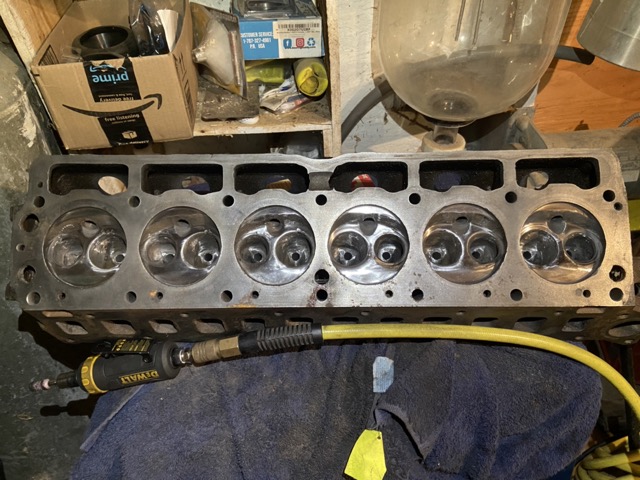

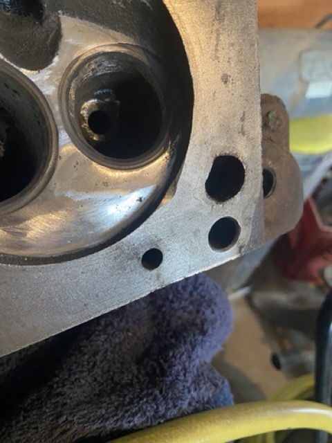

I'm hoping to start porting tomorrow. I took a look at the head to come up with a plan of attack but it's left me a bit confused, either I'm missing something or Mopar created this head to flow the least amount of air possible. In the following responses are pictures I took of an intake and exhaust valve seat, as well as highlighted copies detailing what I think should be removed. If my understanding of porting principles is correct, that means I need to remove the acre of metal highlighted in red without touching the area highlighted in green. Is this correct? I almost can't fathom having to remove that much material.
Additionally, the valves seem very very close to the edge of the combustion chamber. I will be installing oversized valves (some of the existing seats have been compromised due to corrosion) but will they even fit? seems like a mighty tight fit.
Back to porting. I'm planning on porting in the bowl area and only polishing up the rest of the runner. I'd really prefer to not cut into a coolant passageway or mess up something with the valve guide. Is there enough material in the bowl area for some "spirited" porting, anything I should watch out for around the area of the valve stem?

Yes, the casting vs. machining around the bowl and valve entry is often terrible. In short, you can remove the red parts. You can get the seats rough cut for the new OS valves first before you port, but it's not necessary. If you wait to cut the seats and do porting first, it might actually be a nice limiter for your porting in the red area. You will gain a lot of HP and torque and lose nothing. What OS valve sizes? Yes, you have room for a lot more than stock and there is plenty of lateral room, although you need to worry about cylinder bores too. What bore size will you have on this engine? 1.70/1.44 are usually economical (if there is still a supplier), fit stock bore, and flow well. 1.72/1.50 SB chevy are also pretty easy to get but need 0.060" overbore to give the exh clearance to the bore or a ground out bore notch. Make sure to get stainless valves and then you don't need hardened seats. Look for 283 Chevy. You don't need to do much but smooth the port. You can take off quite a bit around the guides too to smooth the air path. Make sure NOT to do a lot between each pair of int and exh ports as there is a thin spot in the water jacket casting there.

I'm well under way in porting+polishing, all that's left now is some polishing. I'm hoping to use the 1.70/1.44 valves from Hughes' engine. I'm glad I waited to get the new seats cut, I ended up slightly nicking every single seat. I may still get the new size rough cut so I can do a final round to get the seat area perfect. I did also put a decent gouge in the edge of one of the combustion chambers, I wasn't being careful enough about the angle of my sanding disc while polishing. The gouge is around 0.030" deep, a decent amount, but hopefully that will get eaten away during the milling process (I'm expecting to take about 0.070 to 0.100 total off of the head and deck). Unfortunately for me, my local Canadian Tire doesn't carry a bit that's suitable for polishing that hill area in the combustion chamber, the spark plug opening, or the runner area, so I'll need to look elsewhere for an appropriate bit in order to finish this up.

Looking good. Don't get too close to the seats when grinding because you need a little metal for heat conduction away from the seats. Yes, good you waited before getting seats enlarged. You can touch them up, or just go with it. You will get substantial gains either way.
