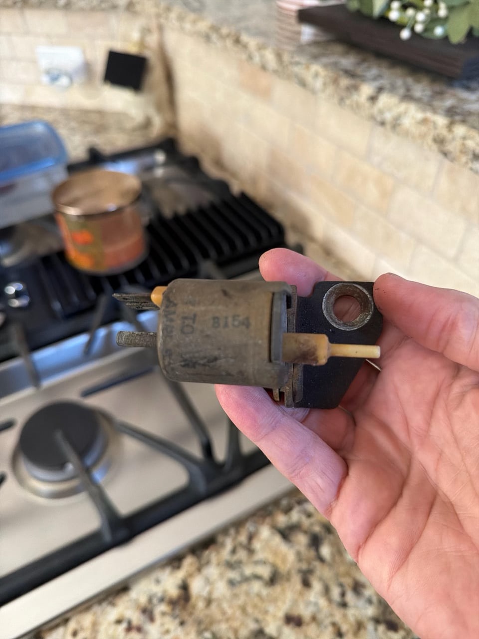

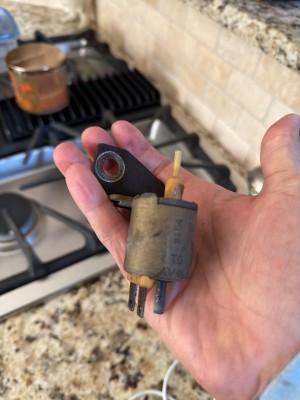

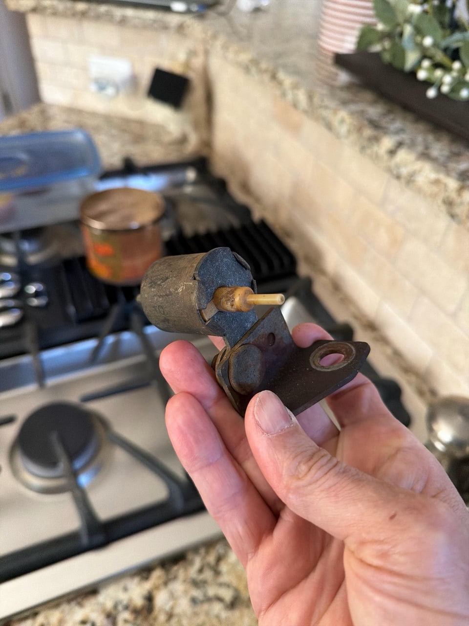

This was bolted to the cylinder head completely disconnected. I don’t know what it is, the engine runs fine without it, but I would like to know what it is.

PostPosted: Tue Jan 27, 2026 2:19 pm
Posts: 10410
That is part of the emissions / Vacuum System from a ~1979 vehicle, and possibly other years. I am not sure if it is slant 6 specific or not. I just tossed one in the can from a 1979 Volare' Duster that I am parting out.
I can get a specific on the exact name of the part for you later, as I have 2 1979 F body cars stored here at the house this winter.

PostPosted: Tue Jan 27, 2026 6:44 pm
Posts: 3293
Garbage can filler
PostPosted: Wed Jan 28, 2026 1:59 am
Posts: 10410
It is a vacuum Solenoid.
There is an electrical connection to it that turns on and off the vacuum signal from the carb to some of the other components it is interconnected to. I am not sure of the other specific responsibilities of the part.
It essentially is an electric valve between carb vacuum and the vacuum amplifier.

PostPosted: Thu Jan 29, 2026 4:33 am
Posts: 10410
Hmm. I do not know if that would originally have been on a 1975 Truck engine, as most of the Trucks had zero emissions in 49 states until 1979, I believe. It is possible that your engine has been swapped at some time in the truck's life with a car engine.

PostPosted: Thu Jan 29, 2026 12:35 pm
Posts: 25072
Vacuum cutoff solenoids like this were used (in various years and applications) to:
• enable/disable vacuum spark advance (first application was '71 California cars – coupled with a 3rd-gear switch on the shift linkage for manual transmissions or to an over-30 speed sensor for automatic transmissions)
• enable/disable EGR (coupled to coolant temperature sensors to preserve at least some pretense at driveability when the engine was cold)
• probably do other things, too
PostPosted: Thu Jan 29, 2026 12:48 pm
Joined: Mon Jan 13, 2025 6:09 am
Posts: 6
Car Model: 1975 Dodge d100
Well I certainly do appreciate all the responses. It’s a shame this forum doesn’t get more activity. No doubt there are a lot of knowledgeable folks here.
Now that I know its function I did find it. Looks like Chevrolet used the same part.

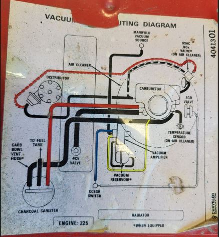

PostPosted: Thu Jan 29, 2026 1:12 pm
Posts: 2735
Is there an electrical connection?
Could it be the vacuum reservoir?
Here is my 76 emission decal.

PostPosted: Thu Jan 29, 2026 1:30 pm
Posts: 6
It’s a TCS
Here’s the identical part
https://www.corvettecentral.com/70-spar ... 6cE80OU6W-
