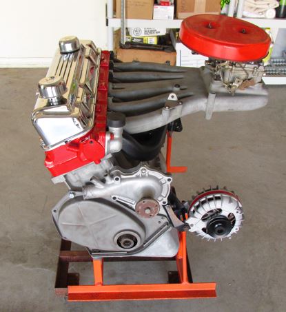

Slim chance I know, but any leads on either cam?
I know, I know, why?

So,why? :D :D No one will know and there are much better running cams, right. :D :D

Get the specs and have Ken at Oregon Cam Regrinding regrind it on an OE core. I am not sure if that is an option for you. If I needed that cam, that is what I might try.
Do those old Hyperpak cams have part numbers stamped on them?

Here is the part#/ specs from Dan. I'd like to see the @.050 numbers. That also appears to be a lot of overlap?? But looking at other comments it appears that is about the range the hyperpak like.
Chrysler Hyper Pak camshaft part № 2205 620:
276° intake duration
268° exhaust duration
52° overlap
0.430" lift

All fairly good answers, except the lawn mower cam answer, that is totally wrong.
I have never seen one, or the Melling either.
Wondering if they exist.
Not looking for the easy button, looking for the real deal.
