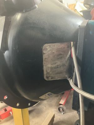

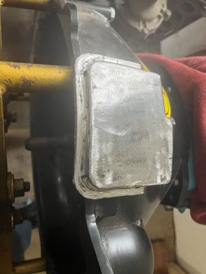

I also have a Quicktime blow proof which had a large hole for where the clutch fork would be. But I am running a McLeod setup so all I have is 2 hydraulic lines. I bent a piece of 1/4" plate to the proper bend and welded a flange on it to fit into the hole. Then I will bolt it into place. That will eliminate about a 3"X4" hole out the side in case of explosion.
Everything has been disassembled to the point that the engine and transmission are ready to lift out. Probably tomorrow morning will be the time.. More to follow! :D

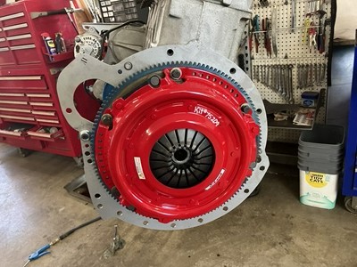

Mounted the block plate and flywheel with lock ring. Installed new pilot bushing. Test fit the starter since this blowproof had the starter mount moved out @ .400" so I can run the V-8 flywheel and clutch. Engagement looked great. Mounted the clutch , Pressure plate and then installed the blowproof. Now I will stick this in without the trans so I can see how much I need to massage he floor pan / firewall area. If it is too much I will just cut out a large window and make a new plate for over it. Not like this is a show car! :D :D

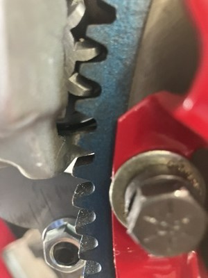

Starter tooth engagement looks super!

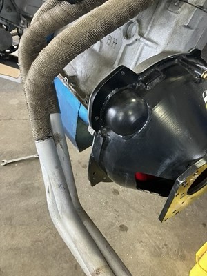

Plenty of header clearance to the bellhousing.

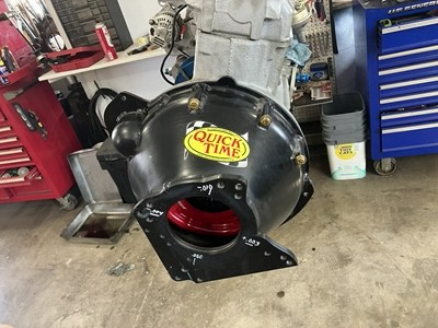

No clearance issues with your headers?
PostPosted: Sat Feb 14, 2026 7:50 pm
Posts: 9545
No actually. The bellhousing clears the headers by about 2" and I am running the hydraulic clutch setup, so no Z bar.
One thing I did forget, and I ordered them about 2 hours ago, was a new set of the poly engine mounts from Johnny Spiva with the steel interlocking brackets built into them. Once they arrive I want to get the engine sitting exactly where it is supposed to be and then see how my headers fit. There is a possibility that I will put the hot wrench to them to get them to be a little further from the torsion bar. I have been running a truck style interlock motor mount on the driver side with a spacer. So adjustment may be needed.
I sat the engine down in the car with the bellhousing on and it fits pretty well. It was touching or very close on the top most bell bolt. So I marked that area (The whole way around the top of the bellhousing) and then took the hot wrench and a small dead blow hammer and "massages the area back about an inch. Also heated the pinch weld and rolled it up flat just to be sure. More to come.
Here you can see the bolts at the top and right hand side. They are actually about 2 1/2" long and have a welded tube into the blow proof. This actually makes the bellhousing quite a bit deeper towards the firewall in those areas.

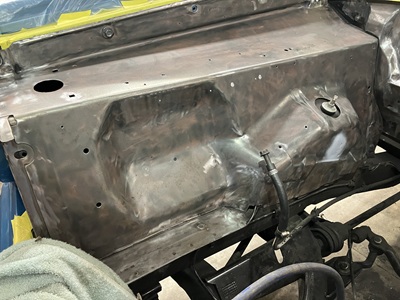

With the engine out I had always wanted to repaint the inner fenders and firewall to match the outside of the car. It is a dirty rotten stinkin job as my dad used to say! :D Plus I know Robbie (painter friend) is extremely particular. And he is going to come over and shoot the engine bay with an epoxy primer sealer, so I wanted it clean. I have wire wheeled and scraped and sanded off and on for the last 3 days.I'm almost finished. Then I can clean everything up , tape it up and give him a call. He is only 3 miles away, and will just come to my house and shoot it. Body filler to the passenger side of center is where some guy had a clutch explosion in 1977! Forgot that was there, but I did redo it and will hopefully cover it up for the last time in my lifetime. :mrgreen:
Also sat the engine back in (3rd time) and verified how it will sit on factory mounts. I saw that my K-frame on the passenger side at the oil pan was all but touching. So I pulled the engine back out cut another piece out of the K frame and welded in a plate that was back about another 3/4" for extra clearance.

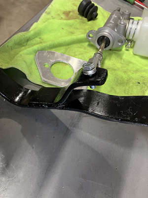

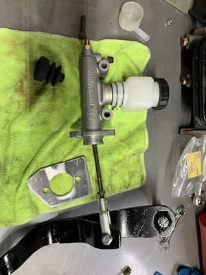

Mounted the clutch master on an aluminum plate I made, that sat in beside where the steering wheel goes through the firewall. After 2 hours of fiddling I realized it was too far down on the pedal and I would only have about 2" of pedal travel. Not going to like that. Started over and ended up mounting the master through old speedometer hole. Looked just about right! I made a Z-shaped bracket and welded it to the original clutch pedal so it lined up on the center of the master. Mounted everything including the offset Brake master cylinder and everything looks good. Probably 4 1/2" of pedal travel now. After carpet padding is in I will bolt in a pedal stop so as not to bottom out the master cylinder. I made a small stiffener plate for inside the car behind the master, but I will fabricate a nice bracket to go from the inner fender back to the master cylinder.That will take out all flex in the firewall. More to come.
