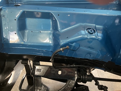

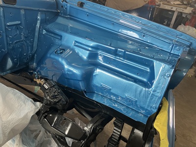

All of last weeks sanding , grinding and cleaning paid off. Inner fenders and firewall now matches the car perfectly. Glad that is done.
Now to get that engine and transmission back in without touching the paint. Did Houdini ever do any Mopar work? :D

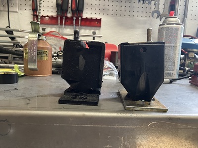

New Poly motor mounts with interlocking steel inside. No need for a engine brace with these. Steering coupler rebuild kit should be here tomorrow.

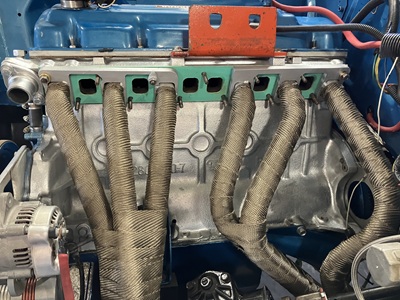

Engine and transmission is back in the car for the final time. The placement on the new poly engine mounts definitely moved the headers in the chasis. The front 3 tubes on the Clifford long tubes that go down through the K frame actually have some better clearance. The rear three tubes are laying tight against the torsion bar. I unwrapped the header wrap and bolted them into the car with a new gasket. Then I took the rose bub and heated the header tubes from the head out about 8-10 inches. And with a strap around the collector I slowly pulled them over about 3/4" off the torsion bar. Of course I had laid wet towels all over the new paint and covered it with some sheets of aluminum I had to protect the paint. No damage was done! :D :D

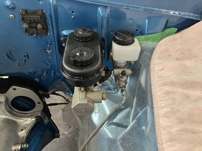

Offset master cylinder mount

Headers were repainted and wrap was put back on. So maybe Monday I will get them back into the car permanently. I did notice there is some pitting in the metal so I am not sure how many years these will last. They don't have a hard life like many cars so hopefully they will be Ok for another 5 years. At that time I'll have to do something because none of the existing headers fit the Webers without serious modification. More to come

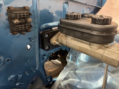

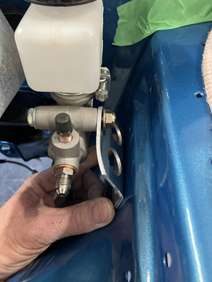

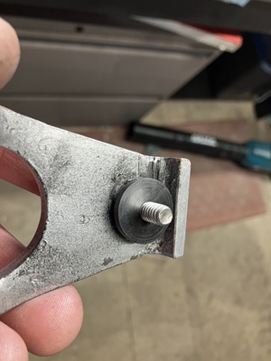

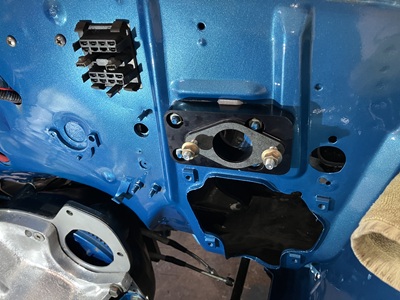

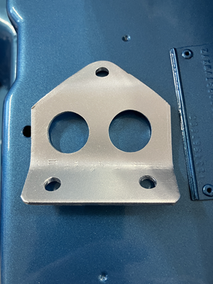

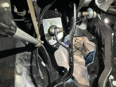

Here is the new bracket I made for the clutch master cylinder to fasten it to the inner fender well.

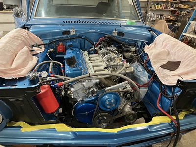

Headers were unwrapped, installed after new motor mounts, heated, bent, removed, painted and then re-wrapped and finally installed.
Engine gets a lot of stuff put around it! :D

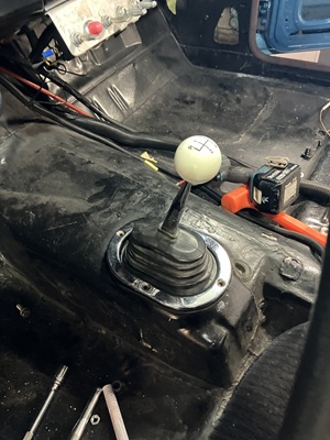

Cut the shifter hole a bit larger. Then welded stops on the shifter since it had none. Then installed into car with new boot. I will test drive before I do the final carpet and seat installs.

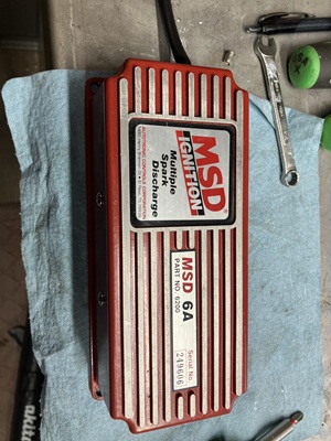

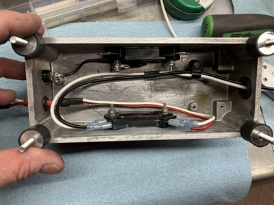

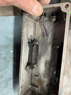

Also installed a new top secret dual ignition system. These are prototype MSD system that are not on the market yet. But they do provide a neat sneaky ignition setup. Also gives a use for all those MSD 6 series ignition modules that have been crapping out! :D :D Two new GM HEI modules tuck in neatly and the whole housing is a thick aluminum heat sink. :D

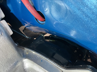

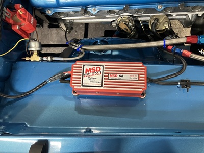

I completed all the wiring under the stealth MSD. I used all the existing holes from the real wires to run my HEI system in and out. Thanks to Matt for sending me this "junk" MSD.
Once installed it looks almost like an MSD ignition system! :D :D
