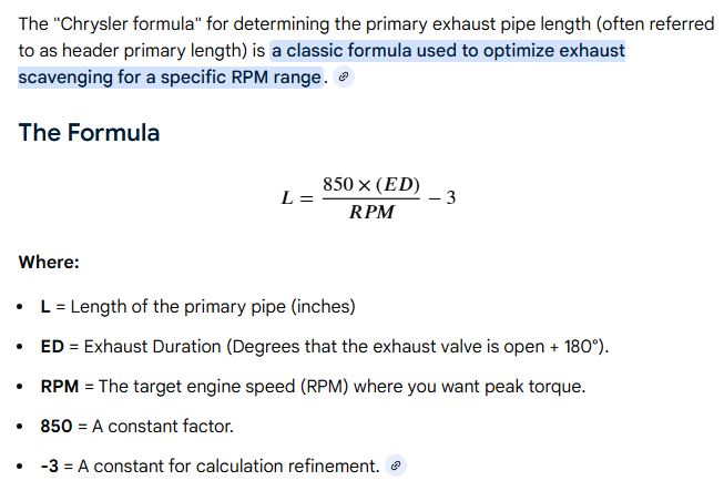

Here is something you can play around with:

Note that Wkstiner is trying to optimize secondary pipes, not primaries (header/head) pipes.
What is the cam you are using? I assume it's the bigger one you can get from summit? Please post specs.
