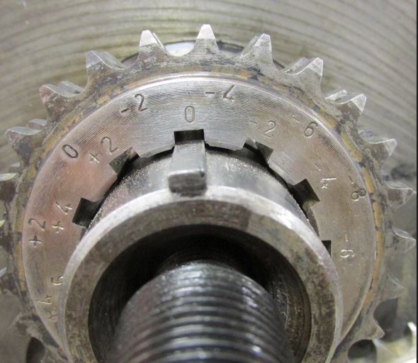

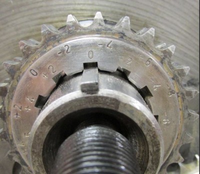

Anyone using the multiple keyway lower gear on a roller timing set?
So I have been fortunate to have the Direct Connection sets and just use an offset pill on the top gear.
With these sets that Jim Cox used to sell the bottom gear has 2 sets of numbers, each different.
Can anyone explain that to me?
Do you use some kind of installation tool to get it on the crank snout?
And then use a puller to remove it and reposition it each time you make a change.
Just trying to see the advantages.
And understand the bottom gear.

Top set of numbers is the timing mark that gets lines up with mark on cam gear that corresponds with inner circle of numbers closest to keyway you're using

And yes I looked at it and figured out the top numbers line up with the cam gear dot.
The inner number is the Advance or Retard you need.

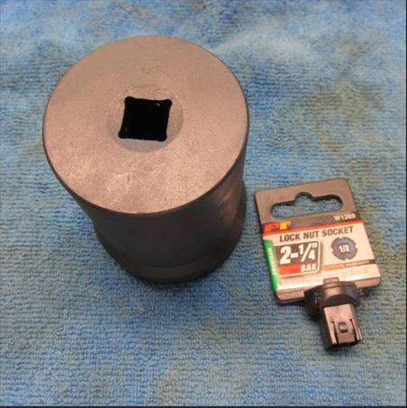

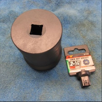

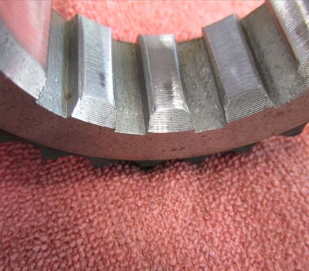

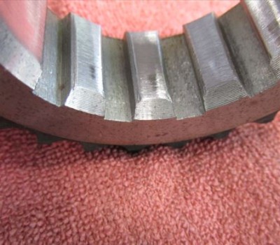

I did some measurements and it wasn't too bad.
I used a flap wheel a few times and got it to where it went on with just some light taps.
I bought a large front axle socket and it was perfect to use to tap it home.
And my 3 arm puller will pull it off without much effort.
