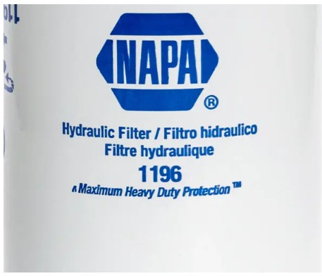

PostPosted: Mon Aug 17, 2026 5:12 pm
Posts: 2734
Dan, any thoughts on NAPA 1196?
Industrial Hyd Filter.

PostPosted: Mon Aug 17, 2026 5:24 pm
Posts: 25072
Not suitable. This is not an engine oil filter. And even if it were, it wouldn't fit (wrong thread size).
PostPosted: Mon Aug 17, 2026 5:26 pm
Posts: 2734
Thanks Dan
Ask and you shall find out
