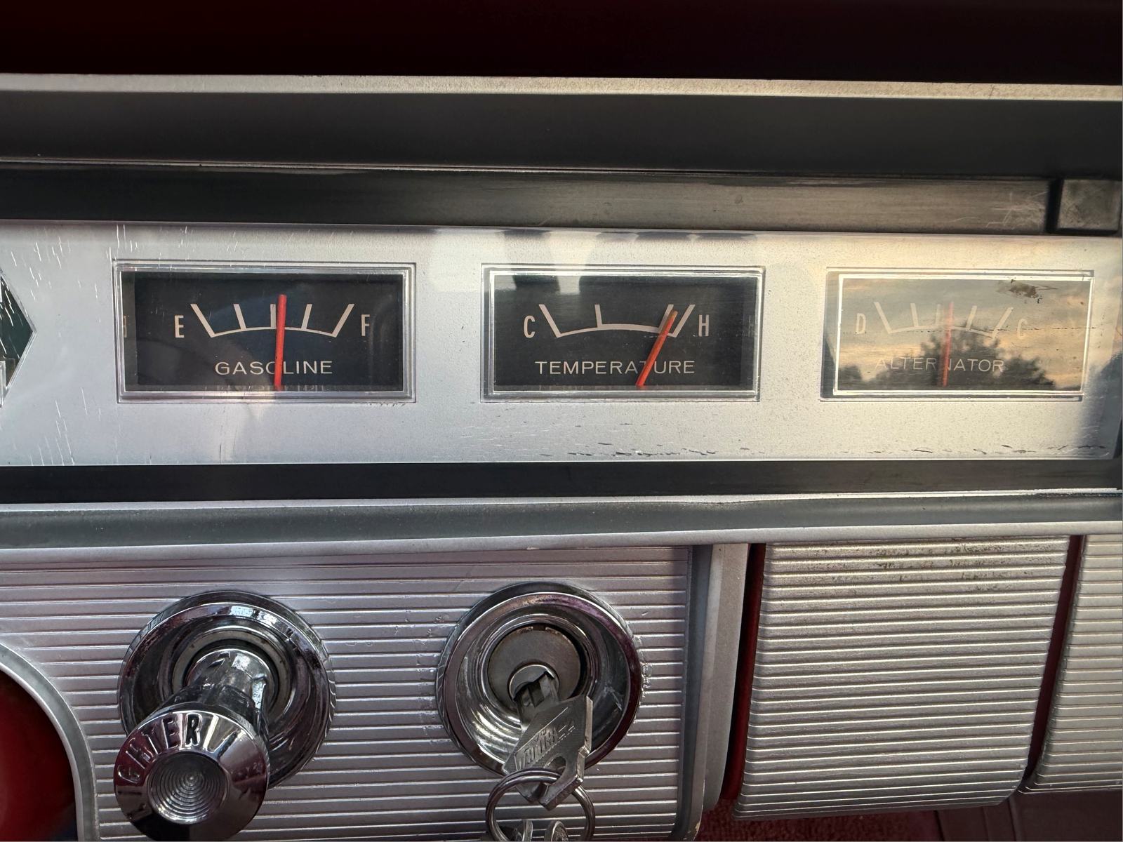

I've been running my car last night for the first time in about 4 weeks again and noticed the temperature goes way up. I used to have a themostat that got the gauge right in the middle, more towards the cold in the normal operatin grange. The current one was always a bit more to hot, but let's say in the middle of the normal operating range, but lately it is at the high point of the operating range.
The thermostat still works, opens and closes. there is no leakage, I drive fairly slowly but also take it up to 70mph now and then. The car is as stock as can be. should I put in a thermostat with lower temp and if so, what is the correct thermostat for it?
EDIT: and the correct radiator cap? is there a part number? I can only find 'this will fit, and this will fit' but when I ask questions to these aftermarket sellers, what are the specifications, I get no answer, only that it fits...

PostPosted: Fri Aug 28, 2026 8:13 am
Posts: 3238
Time for a good flush. I like putting something called "iron out" in there after flushing it with straight water the best I can, leave it as just water and pour a cup of iron out in there and let it warm up good, maybe take it around the block even and flush again and see what comes out .. I have an 80s truck 3 row radiator soaking in a mix of that stuff laying on ots back on a set of sawhorses right now ... 2nd round, it's been sitting like this 3'-4 days now, I'm gonna flush it again with the garden hose this weekend.... I can tell already by sloshing it around there's a bunch of loosened up crap in there.
PostPosted: Fri Aug 28, 2026 11:09 am
Posts: 25021
What are the details on the thermostat presently installed in the engine? Brand, temperature rating, where purchased? Without at least that information, we can't know if you have an actual overheating problem, a wrong thermostat, a need for an engine flush, or what else.
