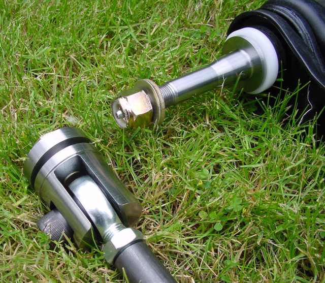

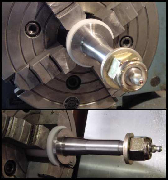

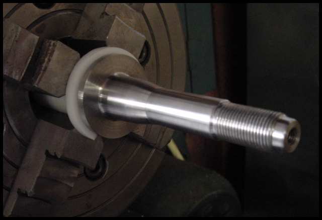

So we are to the last part of creating a pin, sort of...since I also need to cross drill the channel, and set the first pin up again to finish thru drilling the grease channel. But I think I will finish both of those tasks today, what better way to spend the early part of our nations birthday than creating cool car parts.
In this next picture you will see that I have threaded the end of the pin. I could have used the threading functions of my lathe to cut these, but I didn't have a proper thread form lathe tool. What I did have was the correct tap, so once again for just two parts I did this manually:
Again I don't want to bore you guys with too many detail pics of silly things like taps on the end of something. Taps give a pretty harsh finish, and even good tools leave minor scoring of the parts you are turning. One of the ways I get the really nice finish you see in these pictures is to just turn on the lathe, and polish the part for a moment with a strip of sand paper. The crease of a folded peice cleaned up these threads nicely.
I am using a nylon lock nut on the pin and a grade 8 extra thick washer as the clamping medium:
The almost finished pin turned out fantastic and the second one looks as nice. So I will finish the pins today, and then set up to do the bearings. Cutting the grease channels in the bearings will be interesting. I want a channel on both the ID and OD and need to connect them, however, I don't want to weaken the bearing to the point it cracks near the machining of the channels. I haven't decided what to do yet. I will have to use a custom ground boring tool to create the inside channel, and probably use my mini lathe so I can be inside with the air conditioning when I do it...
By the way, the reason the diameter of the flange on the pin is not the same as the bearing is purely economic. The extra diameter for a steel bar was a huge step up in price relative to any percieved benefit. Since I already increased the flange area by a huge margin over stock, I figured that was good enough and not worth another $20 for 1/4" more or so diameter.

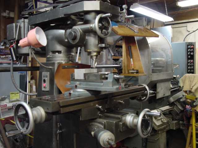

Now...that said, and enough about my personal crap...here is a couple pics I thought you might find interesting before I ditch the computer for another long day and nights work.

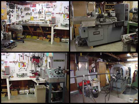

Just so you know where all this stuff comes from...not some shop, but just my two car garage on my little ranch house here in the Eastern part of the city of Portland, not far from the entrance to the fabulous Columbia River Gorge, and only 40 miles from night skiing on mount Hood.
Here is a little older picture of my garage with my turret lathe. It has been slightly rearranged since this pic to make room for the mill and engine lathe, but basically looks the same. My old distributor machine is clearly visible as is the turret lathe I will produce these 12,000 parts on. The gravity fed feed mechanism uses a couple pullies and counterweights to feed bar stock from the rear of the machine.
Also in the picture is my little swap meet metal band saw, and you can just make out that I have a small sheet metal shear/roller/bead roller/bender combo.
Hear is a picture of the mill I just bought for $500 with lots of tooling and measuring equipment.

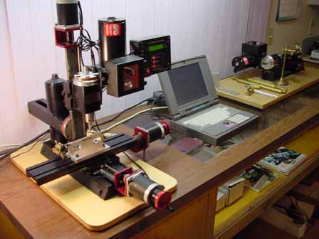

Here is a picture of my dining room, where I eat flying metal chips off my mini CNC mill and mini lathe:
I have built some really cool stuff on these little machines, including a working steam engine that fits in my pocket, a working scale replica of a mill steam engine from the 1880's for my Dad, many carb brackets and linkage pieces and such, some really trick robot parts, some mini dragster parts for a friens kid, adjustable foot pedals for a sandrail...and I use it all the time like last night to quickly make bushings out of brass for various reasons, like to convert a starter motor into a starter for my old racing gokart, or last night I made a bushing to fit a half inch cobalt drill into the 5/8" sleeves on the turret of the turret lathe.

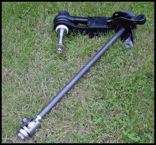

Back to suspension parts. Here is a couple pics of the complete suspension parts assmbled on the front lawn. The strut rod isn't cut to length yet but otherwise ready to go except for the grease channels on the LCA bearings.
And another from a distance:

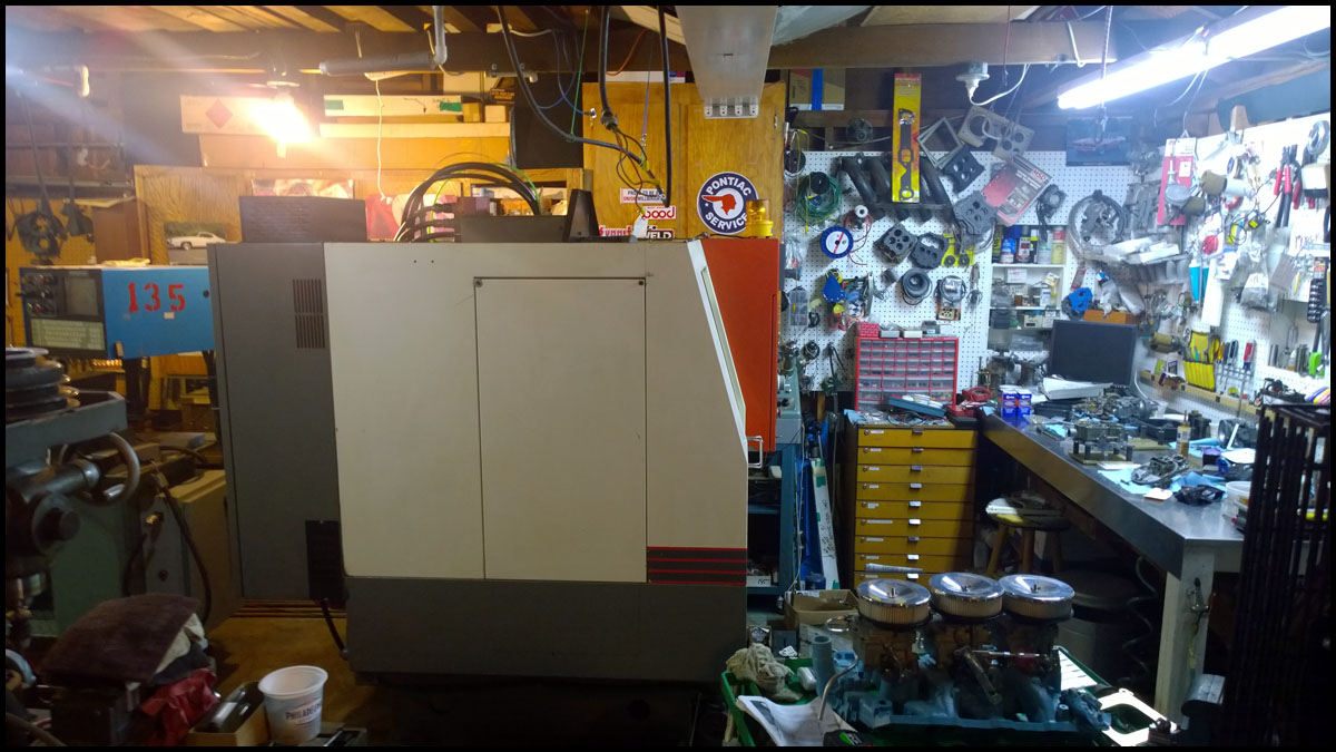

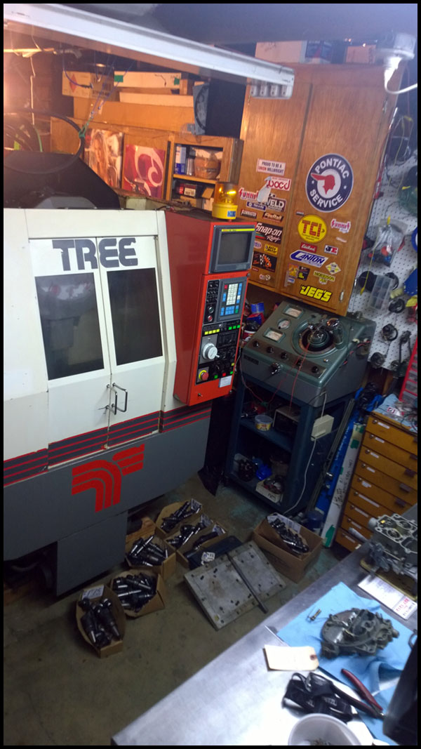

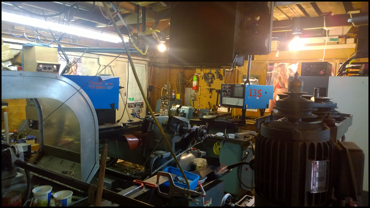

Update to this thread as of May 2nd, 2019...I fit alot more equipment into my shop. 2 CNC lathes, a CNC mill, a precision surface grinder, and another small cnc mill for inside the house in the workshop bedroom.
