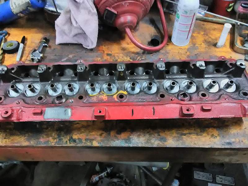

Got the guides cut to the diameter seals I'm using and opened the sprAng seats up a little to accept the Comp 911 big block sprAngs. It's funny, one of the differences of this head compared to all the others I have.....over ten.....I ain't counted lately lol, all the others I have will take a spring bigger than the 1.550 diameter, while this head did not quite fit the Comp 911....I could JAM it down in there, but it needed more room, so I opened the spring pockets just a tad. Didn't go DOWN any mind you, just enlarged the diameter, cut the guide's diameter down a tad and removed the step at the base of the guide as well. But Jerry was right. This head is hard as a ROCK. I had a brand new Comp guide and seat cutter and it took a while.
