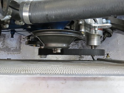

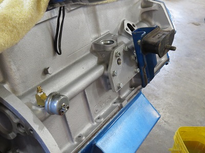

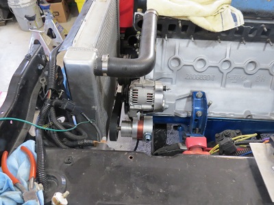

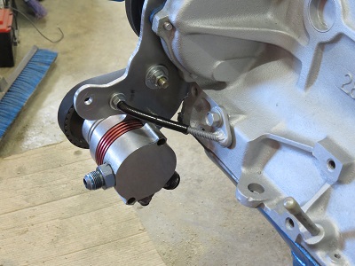

I began the process of the engine & transmission swap this week. If it was only that I would be happy. But I am making a lot of changes and that all takes time. I am usually ready to race by now. I will be pushing it to have this done by Mason Dixon, but I'll try.
I did a test fit of the engine with the new mandrel and oil pump....etc to see if it all fit as I planned. It does and I have just about 3/4" between the radiator and bolt in the end of the crank.
I made a small support strut to stabilize my aluminum adapter. It also allows me to make a small adjustment to get the Gilmer belt running exactly true on the pulley.

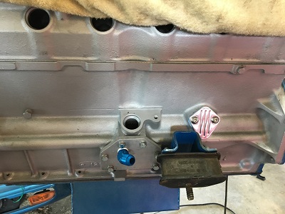

looks great, never fit my lower blower pulley with out moving the rad!! haha. looking at your oil pump block plate, is the hole centered in the block cavity? looks off center, I put mine right on center so flow will separate evenly on raised cast in the cavity. might make no difference once pressure is on it.
PostPosted: Sun Mar 24, 2019 12:00 pm
Posts: 9342
Mine is over the left side main opening. I asked about this a while back and the thought was once it has the cavity filled it should not matter. Soon will tell!
PostPosted: Sun Mar 24, 2019 5:18 pm
Posts: 1245
yes once flow starts it should find it`s way!

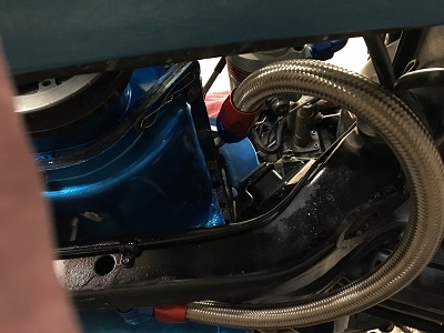

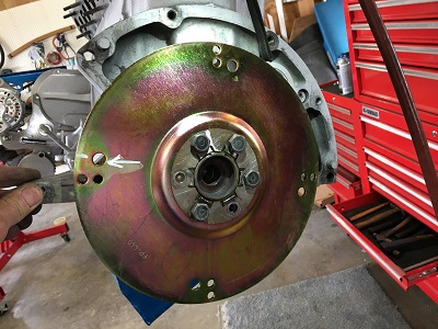

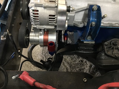

I have the new engine all buttoned up. I got a new SFI solid flexplate from 440 source and redrilled the one offset hole. Got it mounted to the engine, lock ring in place, installed all the locking bolt hardware on the oil pan bolts, installed the alternator and oil pump belt one last time and installed it down in the bay. Made up the 12AN line with internal spring that runs from the pan to the pump. Probably on Monday I will have some help to install the transmission and get all the major stuff into place.
One question? I think I am going to need to go to the smaller aluminum master cylinder because on the Weber carbs. Does anyone know if any of the aluminum ones have the same connections as the 73-76 A body one that I am currently using? I don't mind bending new lines, but if I can purchase one that is more of a bolt in I would rather do that. Thanks!

Hey, I have a question: what is the benefit of using the solid flex plate vs. the X-shaped one?
PostPosted: Mon Apr 01, 2019 3:05 am
Posts: 9342
It is literally twice as thick as the factory style ones. I have always had trouble with the stock ones bolts coming loose in the convertor.
