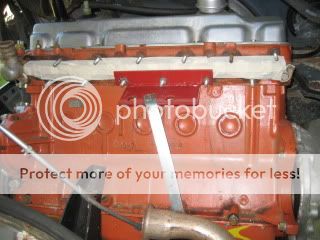

Looks like a piece of angle iron will do the trick..with the right dimensions, that would be a snap to make. (hint hint, wink wink, nudge nudge) :wink:
PostPosted: Sat Jan 10, 2009 12:33 am
Posts: 1533
Location: Seattle,WA
Got one myself that I made.Mid70s chilton man for Dodge vans gives details and measurments.The factory van plate bolts to 3 intake/ext studs and has a strap from plate down to threaded hole by pan. I've got a drawing with sizes around here somewhere would post but my photobucket wont work,it looks almost like Ron's.

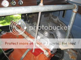

In action with other van related "tool".
PostPosted: Sat Jan 10, 2009 10:35 am
Posts: 830
Location: joyce wa
I should add that my plate is van specific for shop in/out not factory for cars/pickups. It also needed to be moved ahead one stud worth for proper balance.I'll let Ron post sizes for his as most here are not working on vans like myself,you can see the lifting holes are off set abit from his.

I didn't like the idea of hooking chains directly to the bosses, so I made a bracket out of angle iron:
