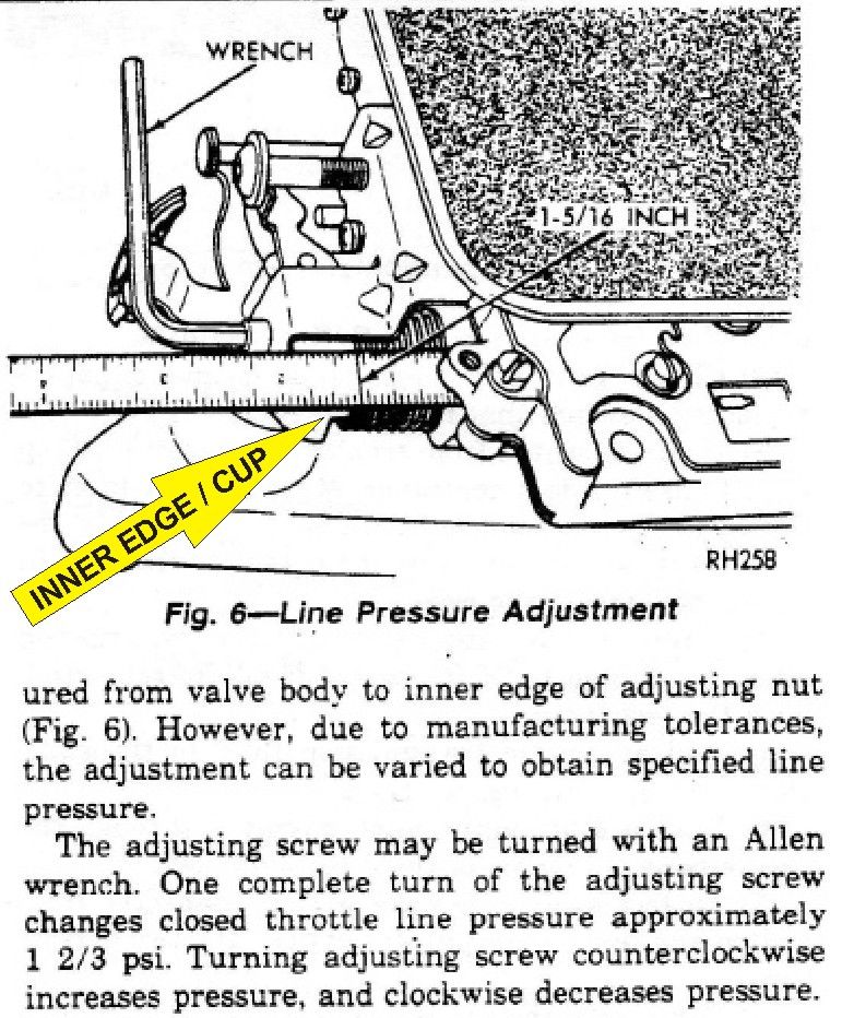

The manual is correct. Counterclockwise increases the pressure.

Well i had my pan off on the weekend to check the rear band and put in my filter extension.I went to check my line pressure and there is no inner edge/cup to the adjusting nut
There is just a yellow spring,which i'm assuming is from the shift kit so i couldn't make any adjustment.
I don't know if the auto shop who recently put the kit in left it out by mistake or if the auto shop who rebuilt it about 3 years ago (before i had the car)left it out.
I do have a spare 904 in the shed that has the inner edge/cup on the adjusting nut.But this will be have to be a future job as the valve body will need a rebuild and i had to get the wagon back on the road.
