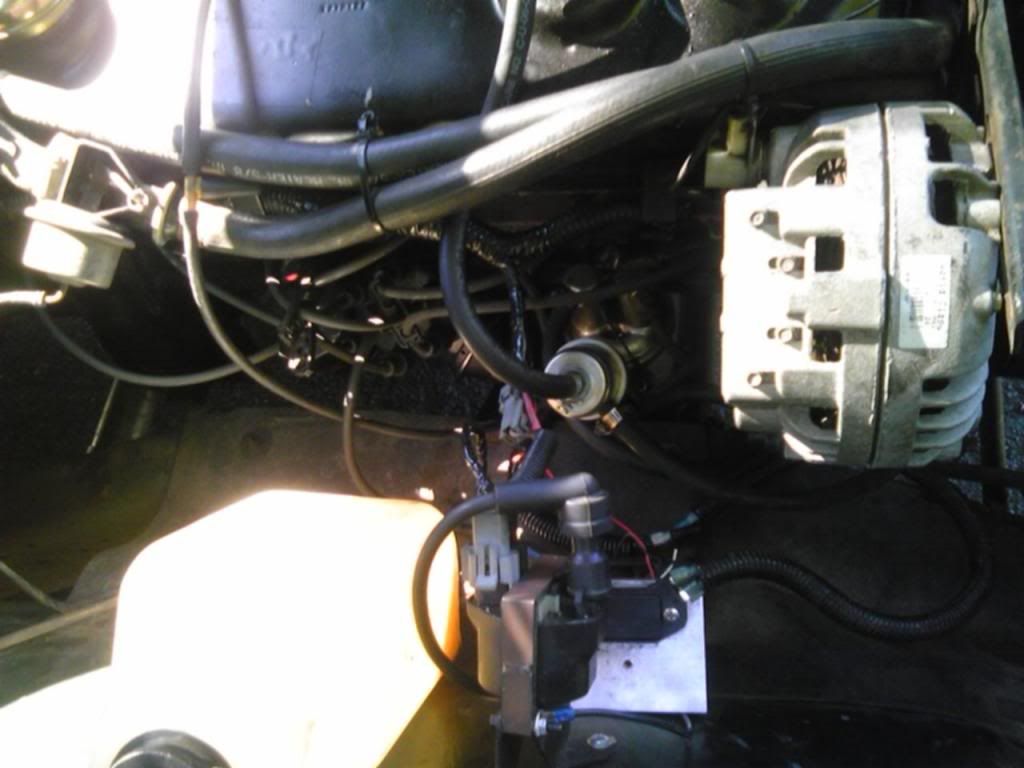

thanks ted. Here are some pics.
I put a quick coat of paint on it a few weeks ago. Just to keep it looking better and more presentable. I will properly paint it when i have time and money.
Cody

Good shots.....looks like everything is going to the right places. The PCV hose is a little too long though.
So, if you pull off the gold anodized breather cap at an idle, air puffs out?
Does your air filter have a black spot on it where the breather tube connects?
If you put your hand over the breather hole to seal it off, does the PCV develop a fair amount of suction after a few seconds?

Even with the breather on it smokes. I'll shorten the Pcv hose. When the air cleaner was white, on the inside where the breather hose comes out, there was a brown spot and oil residue. I'll check for suction.

PCV valve should be piped to manifold vacuum so it sees a constant suction. Air inlet to supply fresh filtered air to valve cover should come from air cleaner on the carburetor side of the filter, or a small gauze stand alone filter inserted into valve cover.
Look here.
Clean hose from PCV valve to manifold if needed. Often worn engines will emit such a rich stream of blow-by, that hose can become quite restricted.

What I ment was that with breather on or off smoke still comes out of the breather hole. Before I repainetd my air cleaner black again like in the pictures, it was white. When it was white, on the inside of the air cleaner where the breather tube is, right in front of there from the breather tube to the bottom of the air cleaner on the inside of the air cleaner there was brown residue, looked Like oil. That is what I ment. And I will check for suction at the pcv when I take the breather off and shorten the pcv vavlve hose.

ok did a few things today. Pulled breather off and covered the hole with my hand, there was no suction from the pcv valve it was doing the opposite and blowing out air. Shortened pcv valve hose that goes to carb. Seemed to be running a little better today but it's been sitting (with about 3/4 tank of gas) for about a week now.
