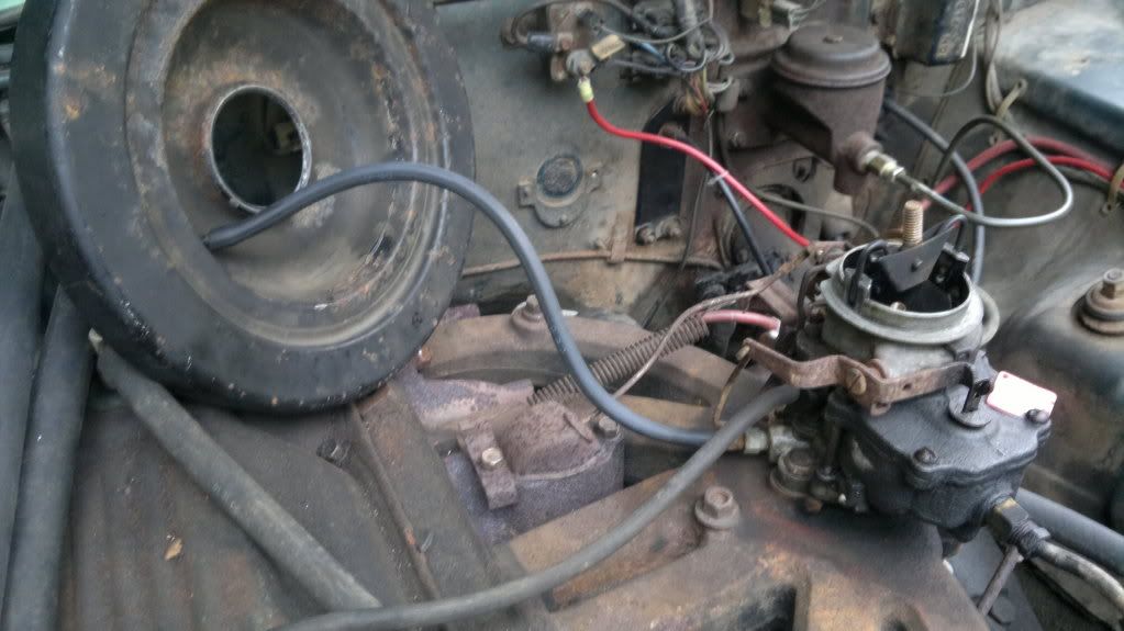

ALSO: ran a short hose from the supposed "anti-ice" port on the carb to the nipple on the underside of my air cleaner. *see pic*
The idle got quite a bit higher as dan suggested, and dropping idle back to where it sounded good, effectivly eliminated any vacuum on the vacuum advance line at idle.
I reconnected the vacuum advance line to the distributor and took a road test.
Still has a bad off-idle miss happening but drives okay at any high rpm and under load. It may be a little bit better, but that just may be my mind tricking me while hoping and quick easy fix was obtainable. ;)
Upon removing the vaccuum advance line the car runs smoother, back to as it was before the discovery of the unconnected vaccuum hose (as mentioned to start this thread)
raises a couple questions: shall I leave the "anti-ice" hose attached to the air cleaner, though no noticeable benefits?
Any thoughts on what this off idle miss could be? bad vaccuum advance unit?
Thanks in advance for any suggestions!
Have you checked to see if your accelerator pump is working? With the choke open and the engine off, peer down into the carb as you operate the throttle lever. You should see a solid shot/squirt of fuel each time you open the throttle. If it's weak/dribbly (or nonexistent) the accelerator pump isn't working and the carb needs to be gone through with a quality kit. If such a rebuild doesn't clear up the misbehavior, or if you find broken/missing/damaged parts inside the carb, then it's time to start thinking about a new (not "remanufactured") replacement carb.
You really need to beg, borrow, or buy a timing light. Before you get hold of one, you can check the accuracy of the timing mark. The timing mark is located on the outer ring of the crank pulley, which is separated from the inner hub of the pulley by rubber. The belt groove is in the outer ring, too. Over time, the rubber-metal bond can let go and the outer ring can slip with respect to the inner hub. That makes the timing mark inaccurate. Specifically, it makes the mark show less advance than actual (for example, if the mark shows 5°BTDC, the actual timing will be earlier than that…might be 10°BTDC, might be 20° BTDC, might be something else, depending on how much slippage has occurred.) To check for this, straighten out a piece of coat hanger wire and insert it into the frontmost spark plug hole. Rotate the engine by hand until the coat hanger wire stops moving upwards/outwards. Check the timing mark. If it's nowhere in sight, rotate the engine further until the coat hanger wire once again stops moving upward/outward and check the timing mark again. It should indicate 0° (TDC). If it does not, the damper has slipped and needs replaced. They're not difficult to buy new.
Yes, definitely leave it hooked up. The benefit is that the throttle plate is now in the correct relation to the spark advance and idle ports.
Sure, but I thought you said it holds vacuum and you can't suck air through it.
(On an unrelated note mentioned in a post above, I do intend to swap out the fuel filter for a metal one, the thin, clear plastic one so close to heat is creepy)
Do the Fuel line mod.
