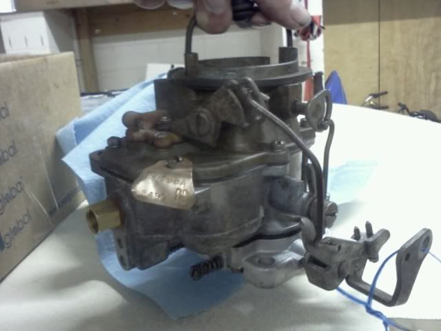

This is my new carb. Any ideas?

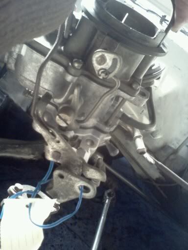

*bump* im having to take out the intake/exhaust manifold to head studs as they had a small leak..
Does anyone have the length of throttle cable it would be for the conversion to supersix from the 1bbl shaft style?

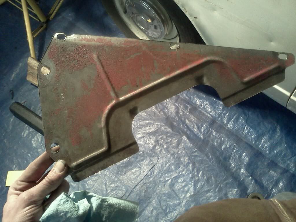

Also, going through my garage again I noticed this.. Image
Any ideas where it came from? :oops:
