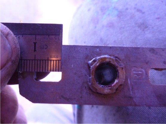

I took my dizzy apart in readiness for my spring kit.
As per bigslant6fan's instructions the governor slot should be .380 or 9.652mm.
My governor has R11 stamped on it and the slot is 10mm.
Would this extra .4mm make a difference?
Maybe my measuring stick isn't the most accurate.
Thanks,
Edit
From looking at other threads it seems the R11 governor is the one that doesn't need the slots shortened.
DRIVE IT,DON'T HIDE IT
PostPosted: Mon Aug 12, 2013 3:03 pm
Posts: 3767
Location: Black Diamond, WA
I run a 15L (.475 slot) with out problem. Shortening the slots are for folks that dedicated have race cars.
Cam Crank Slot length
6° 12° 0.340"
7° 14° 0.357"
8° 16° 0.375"
9° 18° 0.390"
10° 20° 0.405"
11° 22° 0.420"
12° 24° 0.435"
13° 26° 0.447"
14° 28° 0.460"
15° 30° 0.475"
16° 32° 0.490"
17° 34° 0.505"
18° 36° 0.520"
Aggressive Ted
PostPosted: Mon Aug 12, 2013 7:27 pm
Posts: 4295
Location: Gaithersburg MD
I think what you have is good. Go with it. Get the long vacuum advance unit. Total should be 50 when done.
Sam
