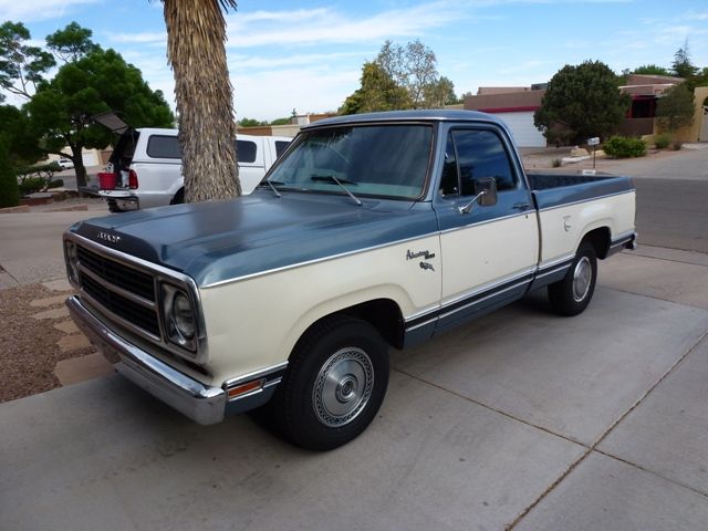

Some pics the day I bought her. I love my truck. Not sure what happened to the quad headlamps or underbody spare tire carrier. I've since replaced the odd Caddy hubcap with a stocker.
http://s1295.photobucket.com/user/Sean_ ... brary/D150
OK, now you have your photobucket account. Look at the right of the PB screen, you will see "Links to share this photo". The bottom link next to the img, click on that. The box should go yellow and say copied. Now come back over here to your post where your typing your message. On a new line, right click and select "paste" (or you can use ctrl V). The PB link should paste in and when you submit your post the pic will be there!
On the headlamp thing, just a thought, others will know for certain.
Is that maybe a "delete" code? The person who ordered the truck did NOT want the quad headlamps?

Sean's Truck:
Man! I like the two tone. Mine is plane boring primer gray, which needs to be re-done in the near future anyway. I might steal the two-tone scheme from yours. I love the blue.
