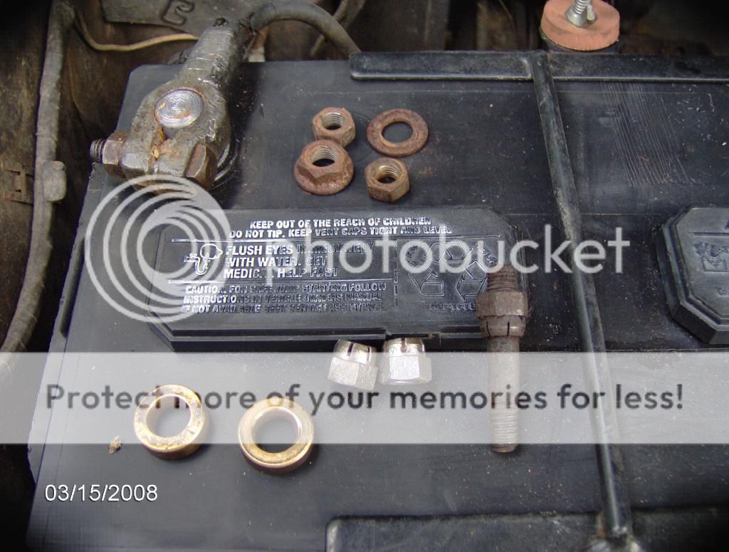

PostPosted: Tue Aug 05, 2014 2:50 pm
Joined: Sun Aug 25, 2013 2:14 pm
Posts: 759
Heck that was easier than I thought, they just came right off, Image
I usually end up with the entire stud coming out like pictured to the right. I have quite a few of these from junkyard vehicles ( that I pull cause you never know who might need one ) and most of the time even putting them in a vise, soaking them down, waiting ect they just will not budge.
I was lucky to have a set that was ready to go though, I will clean up the mounting surfaces a bit over the weekend with at least a wire wheel and put this new hardware on.
Thanks again for the replies.

Looking again at Docs manifold installation article it states............ The two acorn nuts go on the two top, outer end studs, with the coned shaped part of the nut fitting into the dished/conical part of the round brass washers..............
My brass washers appear identical on both sides, I have even laid a straightedge across the faces of the brass washers and I cant detect a dished/conical side?
I see and understand the dished conical steel washer that is in the center position but I see no such thing on these outer end brass washers.
Was this part of the instruction maybe intended for an earlier design brass washer?
These were pulled from slant exhaust manifolds all hydraulic 81 up manifolds.

The brass washers, used on the end studs, are not conical... they are flat-faced, as described.
These washers should have an ID chamfer on one side, designed to accept the slotted "cone" on the lock nut. This special nut grips the stud, when the nut is tightened into the brass washer's angled ID.

Ok I can see that the nut goes in one side further than the other so I understand. Thanks

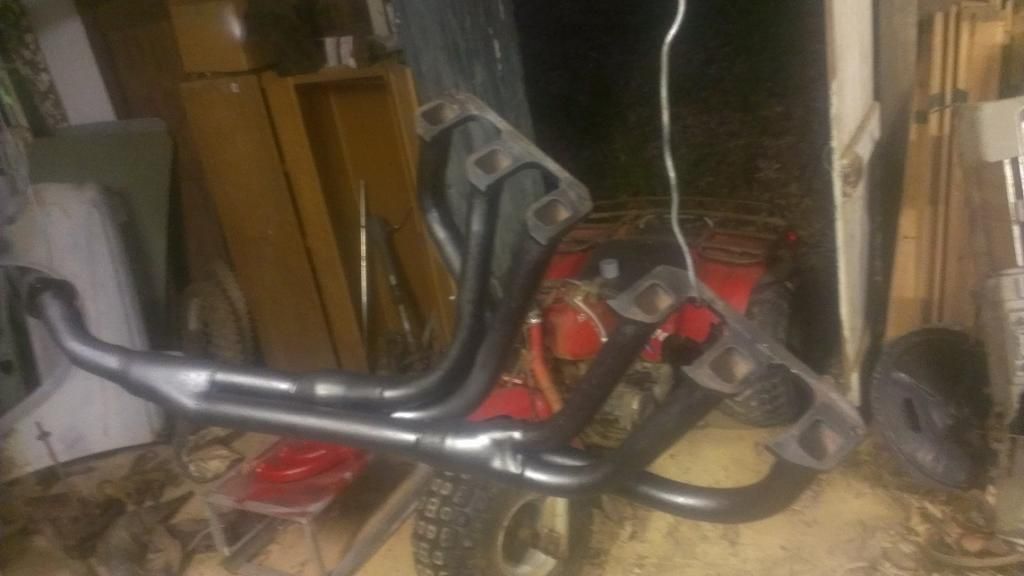

I have done a search but can't seem to find an answer , sorry about the old thread revival.
I am installing extractors/headers on my slant.
Do I still need to use the two brass washers and conical nuts on the two end studs ?

Not if they are 2 piece yes if they are 1 piece.

Would you class these as 2 or 1 piece ?
As you can see all six pipes go to one collector but the front 3 and rear 3 pipes are on 2 different mounting flanges , if you know what I mean , so I don't know if they could be considered a 1 or 2 piece unit.
I don't know what brand they are as they have no markings .

Those are 2 piece, look at the head mount plates.The stock manifold is a 1 piece flange and needs to have the extra movement.
Richard
