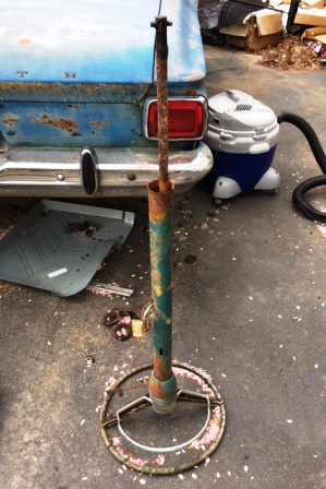

Got a steering column from a 64 Dodge. It is without the shifter parts. The 65 Belvedere column has the cable shift mechanism. The 64 column needs a little work, but is ten pounds lighter. I'll be using a floor shifter with the race transmission.

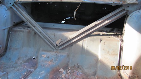

PostPosted: Wed May 02, 2018 3:26 am
Posts: 17571
Why not cut the stock trunk floor out and make that out of sheet alum too? You could add a box tubing brace across the center for strength.

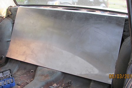

No word on the new trunk floor, but I got the back seat firewall made. It doesn't need to be pretty as it will be covered with carpet.
Before:
After:

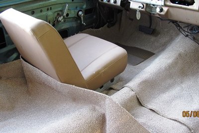

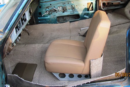

Carpet is going to be a pain. It kind of looks like the driver pad is too far back. If I move the pad close to the area it should be, the edge between the front and rear carpet is under the front seats. Anyway, it will be nice to get the interior at least partly done. One other thing I just noticed. The interior of the car is original 'Fawn' (tanish) color and the outside was originally a sea green. On the inside, with the side panels off, I noticed the rear is the Fawn color but the doors are green color. The doors are the original, as is the interior. Just seems strange.
