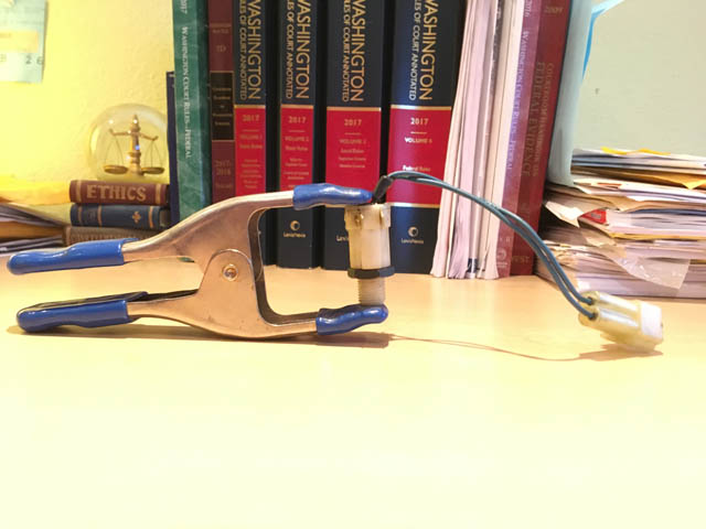

Will do. I had to reglue the original factory switch because it wasn't working right. I am glad I took it back apart because I was able to re-align and clean the contacts for the brake lights and cruise control in the switch. Now I have to wait a few more hours for the Gorilla Glue to dry and try it again.
Hey! The picture uploading works!

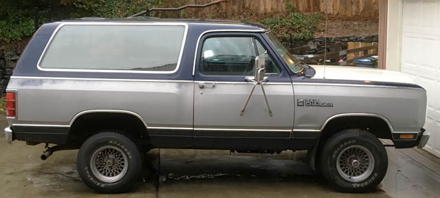

A picture of the Ramcharger. A very forgiving picture. It doesn't show the badly faded paint, rusted out 1/4s, and the rusted out and failed original muffler line. Still, it has a lot of good going for it, not the mention the fact it was a surprise present from my family. :D
