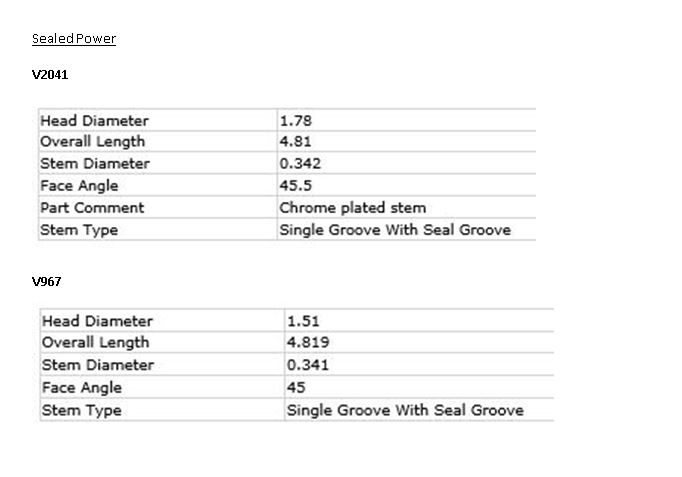

PostPosted: Mon Aug 06, 2018 10:16 am
Posts: 1451
I have used these Sealed Power valves. They are originally for some various ford applications.
They will require new valve guides.
jus' sayin'

That's good to know! Did you have to use different springs, etc.? Seems like those would be a good fit. I need valve guides regardless of what I do, so that's no problem.
PostPosted: Mon Aug 06, 2018 12:42 pm
Posts: 1451
I just had to get new keepers and retainers. I could probably have gotten by with my original retainers. I used the HP 340 valve springs.
-Matt
