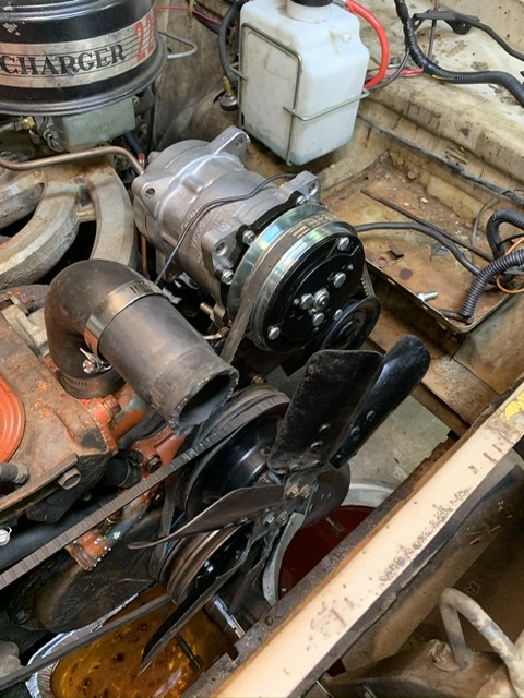

AC doesn't matter as it's driven off a different pulley. AC is an add-on to the back of the damper. Power steering is an add-on to the front of the damper and I can't see your damper in any of your photos.
File comment: See if you can get a view of the damper with this picture.

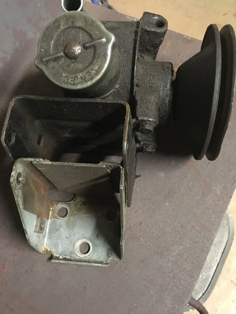

There are different PS pump pulley and pump mounting brackets for the AC / PS 225 SL6 vehicles.
The pulley is much "deeper" and the bracket that holds the pump, has a different mounting "off-set".
I will see if I can get you a photo...
Well, I have been giving bad advice. My mistake. :oops:

File comment: Here is a picture of the pulley I need.
PostPosted: Sat Sep 26, 2020 11:13 am
Posts: 3740
Location: Sonoma, Calif.
This one has a much flatter pulley and longer pump mounting tabs on the bracket that aligns to the front pulley groove.
PostPosted: Sat Sep 26, 2020 12:00 pm
Yup, that's the key. The "with A/C" power steering pump bracket moves the pump rearward to clear the A/C bracketry, and the dished-forward pulley is used to keep the P/S belt groove aligned with the front sheave on the crank pulley.
PostPosted: Sat Sep 26, 2020 4:27 pm
Joined: Thu Jun 18, 2020 12:37 pm
Posts: 28
Car Model: 1966 Dodge Dart 170
Thank you, this is helpful. I think I can modify my bracket to match the one in the picture.
